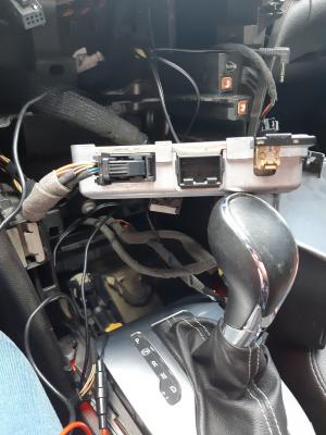

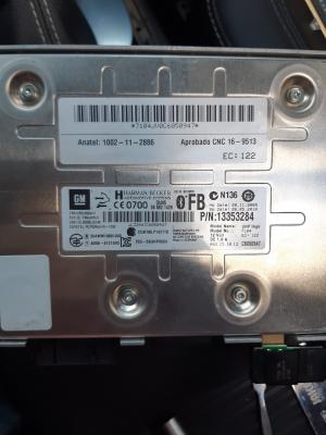

Hello there,
I have a 2012 model Astra j vehicle. I have put your pictures below. There is a cd400 unit, bluetooth module and original microphone installation. Although I have made all the connections, there is no phone features menu. Bluetooth does not work. Do I need to make an extra cable or an adjustment? Please help me. Thank you.
#31
the radio needs to be programmed to enable BT.
#32
(9:th-Sep-2020, 11:17:14)Rusty2009 Wrote: the radio needs to be programmed to enable BT.
Thanks for ansver. VIN programming for tape has been done. How is Bluetooth programming done?
With an MDI and SPS.
