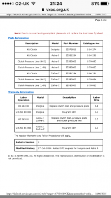

There was a recall on the clutch with engine code A20 DTH found in the 2.0cdti Astra and other models.if your car is less than 8 years old from the time the buttlin was issued I believe your car is untitled to it for free,if you have the following issues, load reversals knocking. When u accelerate in any gear at any speed then lift off there is a slight knock? On and off accelerate and listen for knocking.best to get the dual mass flywheel done aswel but you must pay for the dmf.

I just want to rectify what I said.. it wasn't actually a recall. It was a buttlin. If the customer complains about the issue then it is to be upgraded.if you show Vauxhall the pictures I posted, you shouldn't have any problems.

No just to the 2.0cdti with the F40 gearbox and A20 Dth engine.

Got car in for service on Wednesday and mentioned this bulletin... they going to look into it.
Cheers op ??
My local dealer said this is only covered under warranty!!

When  you speak to them tell them you have a bulletin number.
As to weather it would still be covered is something you would have to argue about with the dealership/ vauxhall.
Be warned they are very good at wriggling out of things.
