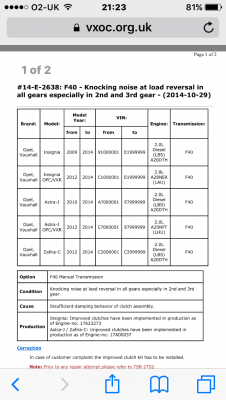

There was a recall on the clutch with engine code A20 DTH found in the 2.0cdti Astra and other models.if your car is less than 8 years old from the time the buttlin was issued I believe your car is untitled to it for free,if you have the following issues, load reversals knocking. When u accelerate in any gear at any speed then lift off there is a slight knock? On and off accelerate and listen for knocking.best to get the dual mass flywheel done aswel but you must pay for the dmf.

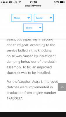

I just want to rectify what I said.. it wasn't actually a recall. It was a buttlin. If the customer complains about the issue then it is to be upgraded.if you show Vauxhall the pictures I posted, you shouldn't have any problems.

No just to the 2.0cdti with the F40 gearbox and A20 Dth engine.

When  you speak to them tell them you have a bulletin number.
As to weather it would still be covered is something you would have to argue about with the dealership/ vauxhall.
Be warned they are very good at wriggling out of things.
