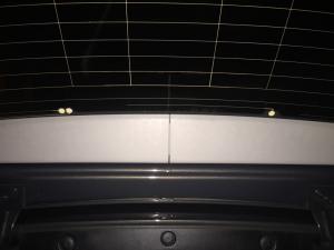

Have you checked your window to see if you have the tabs?
I'll go have a quick look now tucpal did take a look when I saw him a few weeks back though and he said I didn't have them :(
Yep don't have them :(
Astra Energy 63 Plate 1.7 CDTI (150BHP)
no you do not i looked when i meet you

Can the tabs not be fit into the pads? I've just looked at mine and it looks like I have the ariels in the window just not the tabs
Sent from my Samsung Galaxy S4 using Tapatalk
(20:th-Apr-2015, 16:50:38)bhalay207 Wrote: Can the tabs not be fit into the pads? I've just looked at mine and it looks like I have the ariels in the window just not the tabs
I'm sure yours is the same as mine dude...
@tucpal thinks they are soldered on IIRC but you need to find what they are first.
@sheppy1 Yeah I think it is but you can seen the elements in the class and where the pad would go, just missing the pad itself.
@Rusty2009 let the investigation begin
the tabs are soldered onto the plates but it is finding them i looked everywhere
but they only come as part of the glass
I might drop pilkington an email and see if they can help me. Assuming you haven't already @tucpal
