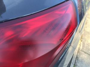

Not sure how you only used a small bit of the can...I've just used a whole can and they still don't like that dark :-/
So it sort of dried matte looking apart from a few areas which have glossy splatter marks on them :( look good other than that
The side that's a bit messed up isn't as dark as the other side either. I've bought another can of the tint so hopefully if I spray some more on this side to make it match the other side it will also make it matte too like the other side...what do people think?

Fair doos, I like it apart from thay bit I messed up lol. Aby ides if I can just paint over it to fix it and make it all matte or will it need taking off and doing again?

rusty says there is a remover you can use to get it off
Yeah I would remove it and start again mate.
Yeah I have the remover, it came with the pack Will try that then when the new can comes. Cheers guys
Think I'm gonna have to just paint over the light because I've just read the leaflet thay came with it and I says a buffing wheel and cutting compound will be needed to get the tint off :--

Really? Try white sprit that's what I used with some elbow grease.
Okie dokie, will try that if spraying over it fails. May just be okay with a quick layer over the whole lot
