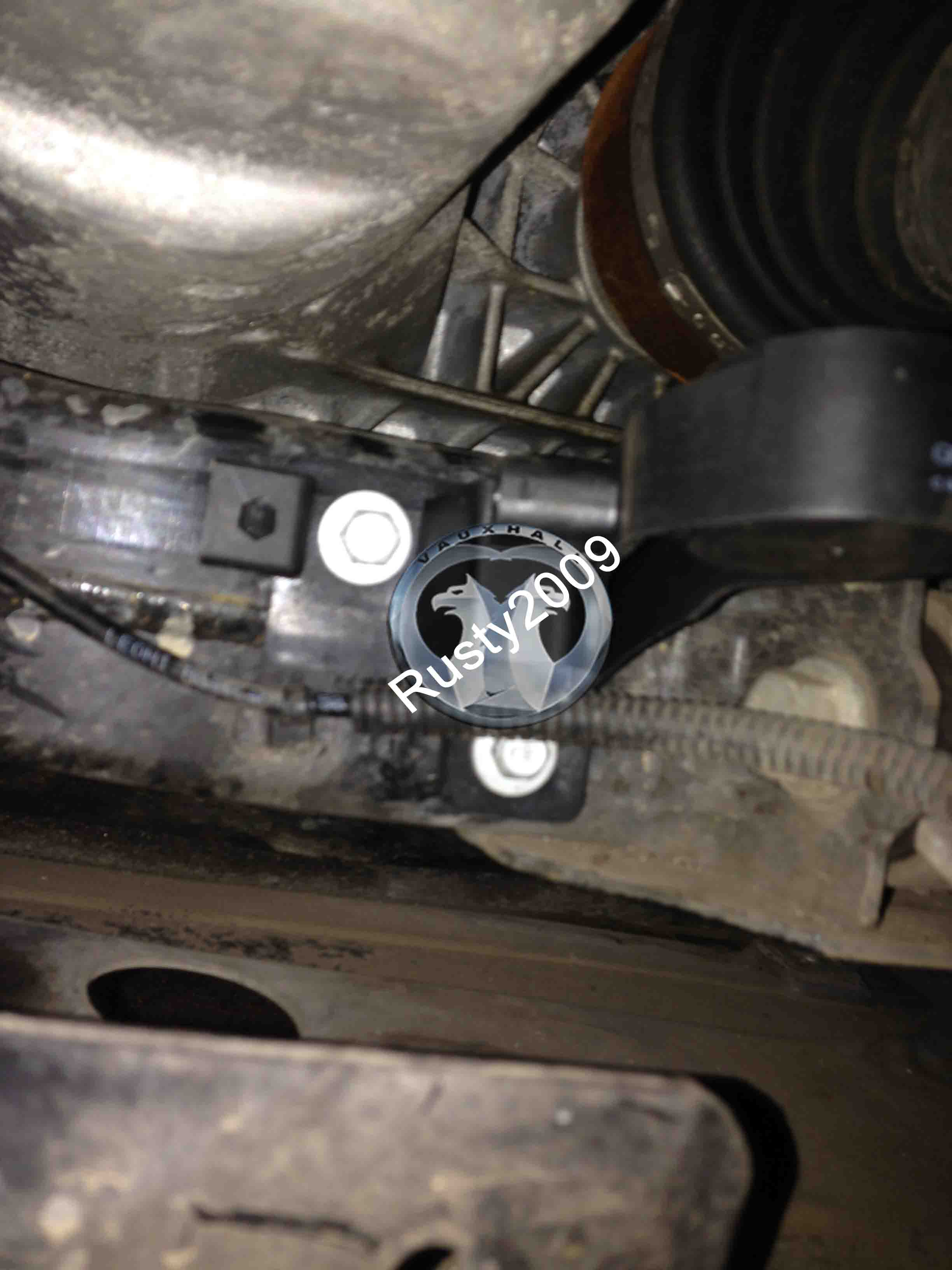

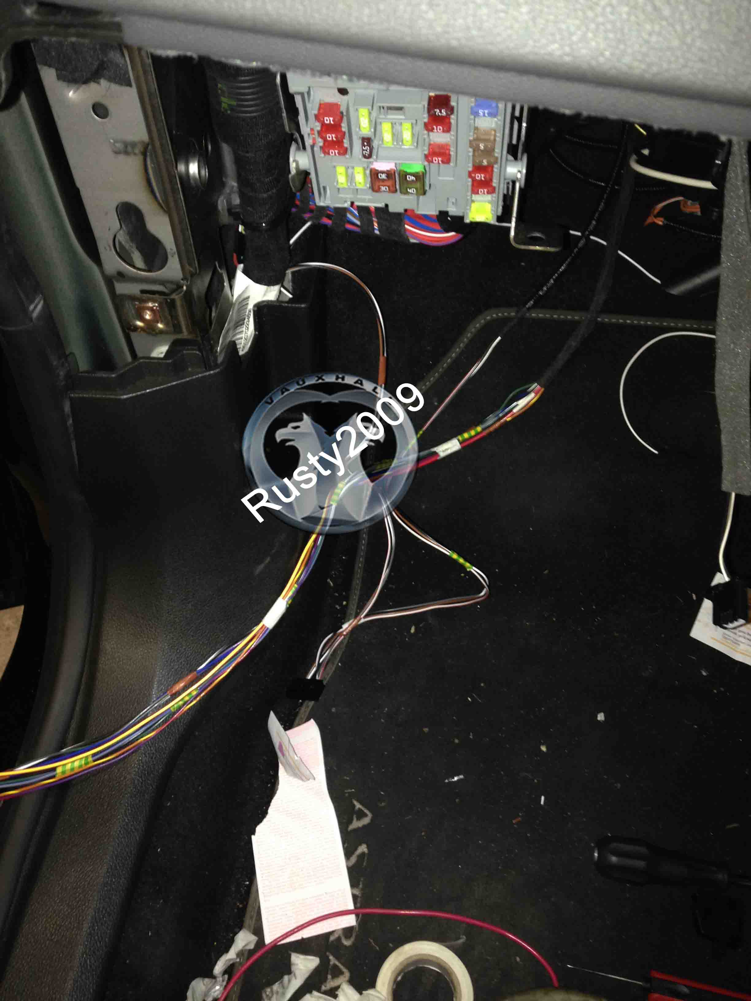

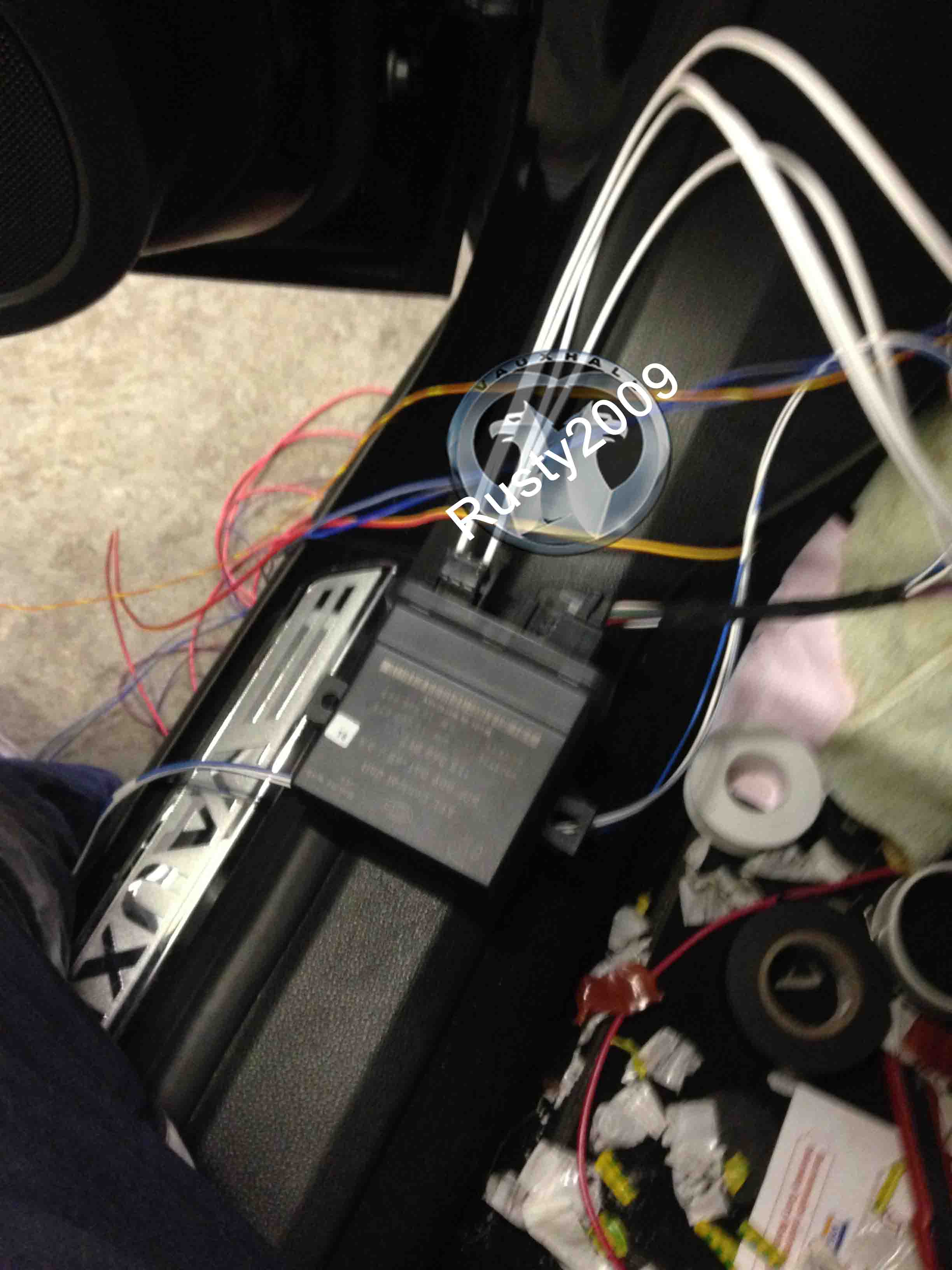

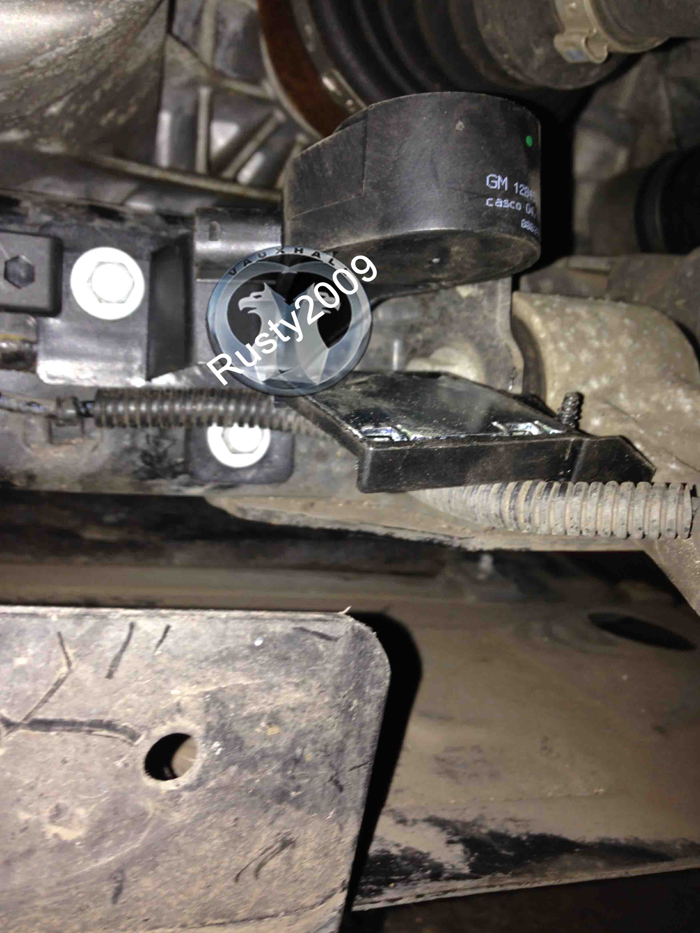

I have now worked through all the wiring etc,
I've fitted the rear levelling sensor and have the wiring in the car for that.
I've got the front levelling sensor to fit and then I need to get the looms into the car from the font end.
Then it will be a case of running the wires and then a case of testing out what happens etc.

Just a quick update to say I've spent the day fitting the front levelling sensor and getting all wiring into the car, I'll start hooking it all up next week.
GOOD i really hope this works mate :cool
Not long to go now hopefully

Just a quick update to say I got the AFL module all wired up and the passenger side all back together, Got all the wires run to the drivers side for the BCM ready to hook up and also got the Wires ready to hook up to the fuse box.
You've been a busy bee.

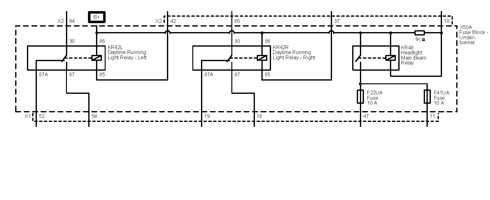

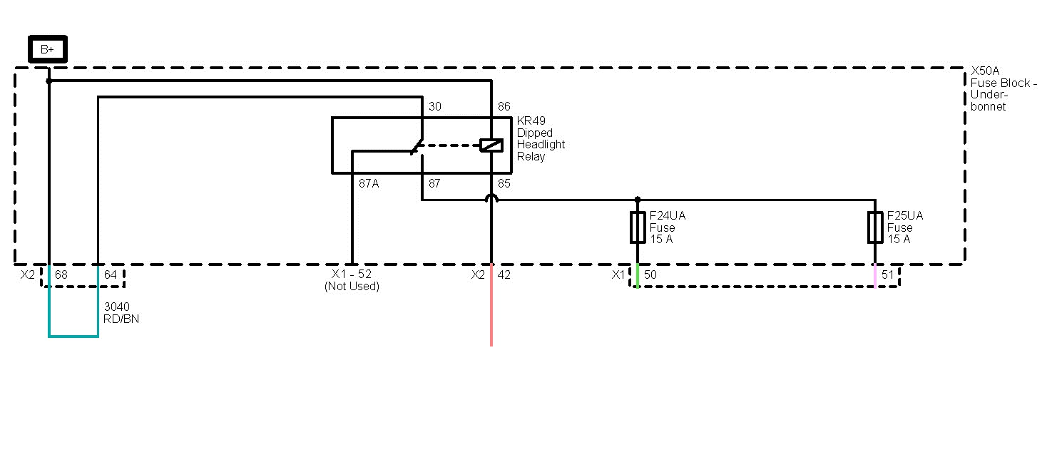

I've just been looking into the fuse box circuits and there is a difference between the two. So it's now two options,
1. Find out if the circuit inside can be changed without ****ing anything else up
Or
2. New fuse board at around £370
Of course programming will be needed.
Oh my @od how much have you spent so far. I get the feeling you are going to be well hacked off if you need to spend that on top of what you have already spent. I do hope you don't need to though.
Just to show you what I mean about the inside circuits.
Xenon
Halogen
It will be a new fuse board that is needed, the board I have doesn't support CE4 = Washer Headlamp High Pressure or T95 = Headlamp control beam directional (AFL).

Just add a couple of pics I found which I forget to add.
Front Leveling sensor
Wiring coming into the car
AFL Module
