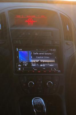

Sorry for the off topic but can you show us a picture of your center console unit?
I have no clue what it is but the small part I see looks very slick!
(30:th-May-2018, 08:37:16)rlievens Wrote: Sorry for the off topic but can you show us a picture of your center console unit?
Hey there,
here you go   .
greetings
Oh now I see, thanks

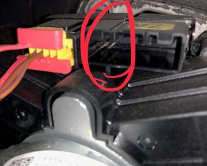

So yesterday i popped the airbag of and there are no cables in there. The plug you showed there on ebay is behind the airbag, but the cables are missing inside the plug. Maybe I‘d have to change the slip ring and buy the needed loom but thats too much work I guess. :(
Is there any pins in the plug behind the airbag on the squib?
Hi rusty,
unfortunately not, the only 2 pins in there are for the horn. The other pins should be for the controls, but they are not there. Thats a shame :(

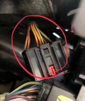

Could be worth carefully taking the squib off as there is a plug the other side that would allow you to see what wires are there.

Today I removed the plastic wheel covers around the wheel to give me a look behind the clock spring squib, and look at there, there are only 2 pins but the plug is full of wires which means it could be done by removing the clock spring squib and replacing it with a used one. Probably cruise control won't work but this can be done by programming surely. But i'm sure the radio part will work
Sorry I've not had a chance to get on TIS yet. But yes I would say the radio side should work fine.
