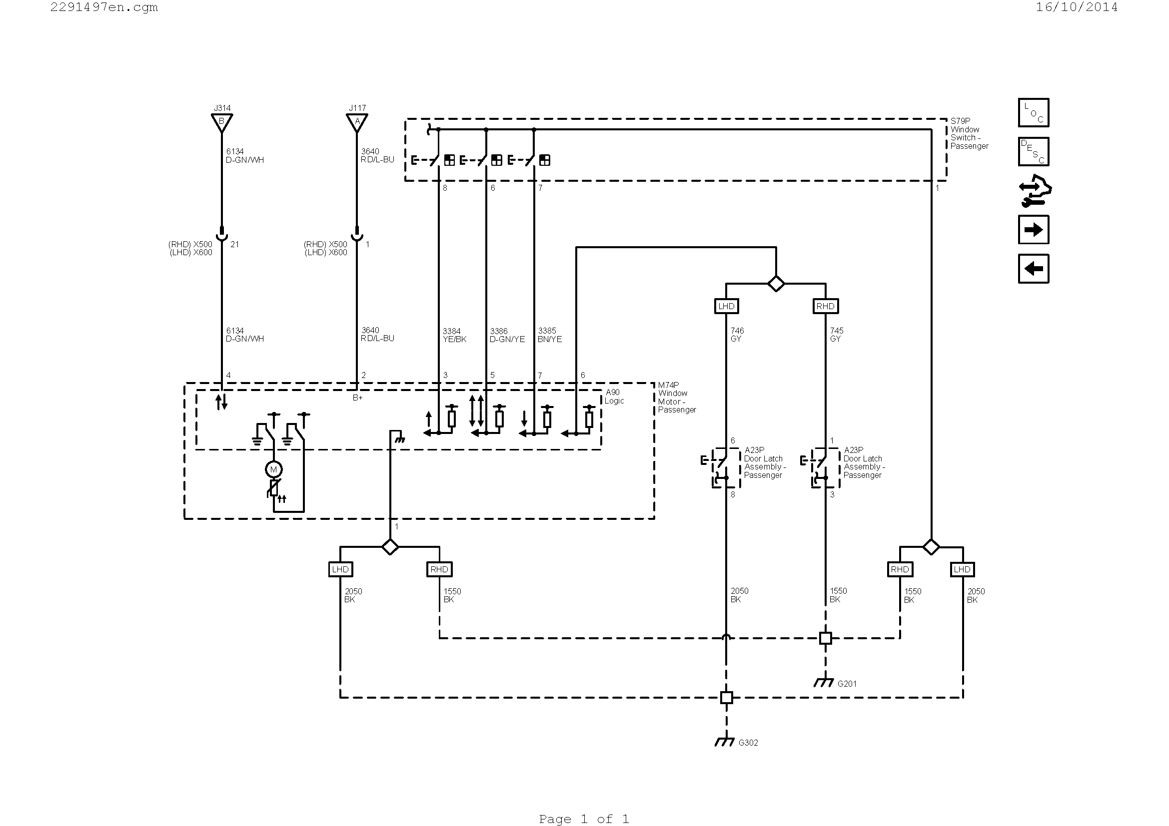

Passenger door
[Image: Passenger%20Window%20%28AER%29.png]

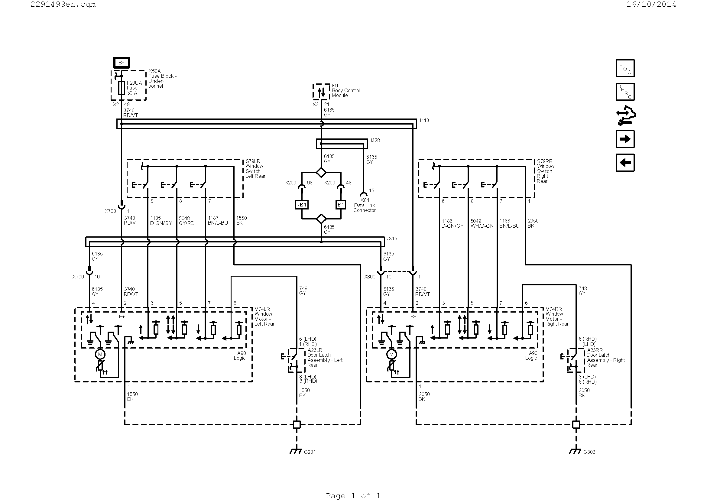

Rear doors
[Image: Rear%20Windows%20%28AER%29.png]
