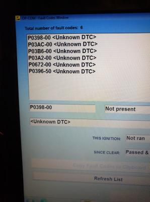

i've got on my dash the svs message, i took the car to a garage for a diagnose, and it came out with code P0672, glow plug on cilinder 2 faulty.
I ordered op-com, and when i read codes i got the same code (P0672) and 5 others.
can anyone tell me if the other codes are related to the faulty glow plug, or if they mean that more issues are going on?
thanks
I would say clear the codes and see what comes back as some of them could be old errors.
Have you checked through the fault code list thread?
https://www.vxoc.org.uk/forum/Thread-Fault-Codes
As John said it could be worth clearing the codes and seeing which ones come back.
DTC P0398 00: Cylinder 1 Pressure Sensor Circuit High Voltage
DTC P03AC 00: Cylinder 3 Pressure Sensor Circuit High Voltage
DTC P03B6 00: Cylinder 4 Pressure Sensor Circuit High Voltage
DTC P03A2 00: Cylinder 2 Pressure Sensor Circuit High Voltage
DTC P0672 00: Cylinder 2 Glow Plug Control Circuit Malfunction
DTC P0396 00: Cylinder 1 Pressure Sensor Performance
yes, i did Rusty2009, my doubt is related to the garage, where only the P0672, came in the machine. Or Op-com is more powerfull than general machines?
i ordered already 1 glow plug (because my car uses the expensive ones, with sensor? i will get it replaced and see what comes after.
thanks
