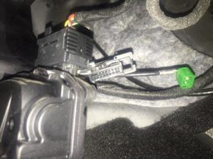

In terms of wiring it depends some cars have the wiring already others don't, you can look in your footwell drivers side see image below.

Ah OK Starting to make sense.
I've had a look and I do indeed have the multiway connector and DAB aerial in the footwell.
