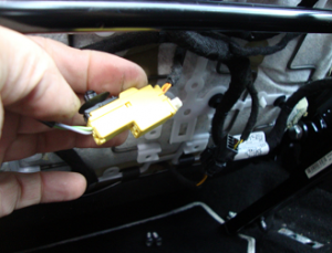

Front Seat Heater Control Module Replacement
[Image: Front%20Seat%20Heater%20Control%20Module...cement.jpg]
Preliminary Procedures
Disconnect the battery negative cable. Refer to Battery Negative Cable Disconnection and Connection.
[TR]
[TD]Callout[/TD]
[TD]Component Name[/TD]
[/TR]
[TR]
[TD]1[/TD]
[TD]Front Seat Heater Control Module Fastener (Qty: 2)
Caution: Refer to Fastener Caution[/COLOR] in the Preface section.
Procedure
1. Move the front seat full backward.
2. Move the front seat in upper position.
3. Disconnect wiring harness connectors.
4. For programming and setup, refer to Control Module References.

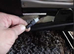

Hello guys,
Im really happy to find some informations on how to solve the seat heating problems on our Opel/Vauxhall Astra J.
Recently I got a B2425 DTC, it said "too high resistance", so I'm guessing it's the B2425 0D DTC. I know where the K29 X2 connector is located, but I'm still trying to find out where I can find the E14A connector.
Obviously it's located somewhere in the back of the seat, but my brain just doesn't want to get it. @tucpal did a really great How To, I want to follow it but firtly need to find out which heating element is broken.
So: Is the E14A connector the yellow one or the white-black one (-> pictures) ?
I' really appreciate your help! Smile
yellow plugs are for the airbags
E14A is not a connector it's a heater pad Which is the Drivers back cushion.
