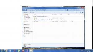

....CDR..DISC...FORMAT....
OPEN THE, NAVI 600 900 RUS FIX.RAR., FILES AND BURN THE DNL ISO FILES IMAGE TO A CD-R or CD-RW DISC not a DVD Disc
USE A GOOD QUALITY DISC LIKE VERBATIM CDR 52X 700MB OR WHATEVER YOUR ARE USE TO
AND COPY THE FIRMWARE IMAGE OF THE ZIP FILE DNL TO THE CDR DISC
USING A BURNER SET IT AT AS LOW A SPEED AS POSSIBLE X1 IS GOOD BUT UNDER X4 SEEMS FINE
THIS WILL HELP TO BURN THE DNL FILE Image AS IT WILL NOW COPY BETTER TO THE CDR AND UPLOAD CORRECTLY TO THE NAVI.
ALSO WINDOWS 7 BURNER WORKS WELL ON A LOW SPEED
BUT WITH THIS WINDOWS 10 NOT SO GOOD
OLDER WINDOWS WORKS BETTER FOR THIS OR USE WINZIP AND ANOTHER BURNER PROGRAM FOR WINDOWS 10
BURNER LINKS LOWER DOWN THE THREAD.

I've downloaded the NAVI 600 900 RUS FIX.RAR but my Win10 machine doesn't allow me to follow the instructions.
It's downloaded as a RAR file, but when I try and open the file, it opens as a Text file.
Any ideas?

Hi Read the first post 100% before you try, you will need winzip to unzip the files with windows 10, be careful if you dont follow the instruction 100% you may brick you system

How I need to burn that ISO on CD ? Is this ok ,like on photo,  or must be burned like ISO ?
You goddam beauty,I have a 2011 Elite with a 600 Navi and following these instructions I now have a 900 Navi,awesome mate,fantastic post!
