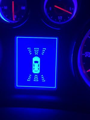

I can't make out the screen from that but if you have the screen I have with 3 tabs
You can get a visual display as well as warning tone.
With the factory fitted system.

i have front and rear factory sensors also
but my display is a bit different to yours rusty
as i dont have the rear on the screen but i have the sensors
and it does bug me i want it like you're one with both on the screen
i also have the same display with the 3 tabs on it
have i missed a setting ??

Ive got the same display as tucpal, haven't seen the other display before either with both on.
(8:th-Jan-2016, 19:31:47)tucpal Wrote: i have front and rear factory sensors also
[Image: DSC03270_zps4tkv6bcg.jpg]
I've got the same on mine mate. it bugs me as i want the display that Rusty has!!
I know its old thread but not worth it to open new one. I have both front and rear park sensors factory fitted but I dont have the display only the beep. Is there any way I can enable this one? Thanks in advance
What display do you have?
Picture is from internet, but mine is the same. I dont have any parking display appearing Smile
Yes you should be able to have the front sensors turned on but it would have to be done via MDI.

Im new on this forum and I have the same problem. I have rear and front sensors and only the beep, i font have this on display. I activated few more thing via OPCOM, but didnt saw this option? Is there any chance I can activate it via OPCOM? And what is MDI, this is stupid question.

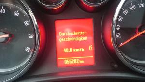

And one more question, how can i activate this kind of BC - http://performancedrive.com.au/wp-conten...luster.jpg

You can't do it with op-com MDI is the dealer tool & it's not cheap £1600 upwards it's not worth buying a clone, then you need to pay GM to use software etc.
The white lights you may have the SMD's on the board which would mean just a case of swapping rings over for white white.
As for that display it's not possible without an IPC upgrade.
