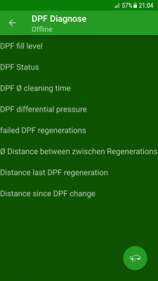

Got my HappyBLue but the DPF diagnostic shows nothing. Any idea? changed the license plate to LED, the fault override seems not to work... upon starting still am getting the "Check licence plate light". Is all of that normal?
@Sheppy1
You are "offline" on the picture you have linked to.
Try starting up the engine and go online.
