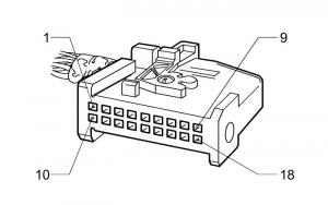

semxoz Wrote:Rusty Hi Please HELP ME, Could you write me a catalog numbers connectors are inserted into the module AFL
I take it you mean you want the part numbers of the connector plugs for the AFL module or you need the Pinouts?
cool faq, I need part numbers of the connector plugs for the AFL module, sorry my english[ATTACH=CONFIG]367[/ATTACH]
where can I buy a connector module afl?
The above is also used in an Astra-H (MK5) Radio.
They are also used for the DAB on the J.
They are not cheap to buy.
Ill look the number up tomorrow.

you do not know me part number?

K28 Headlamp Leveling Control Module X1 ZF18-6 93187174 £41.65 Autovaux
