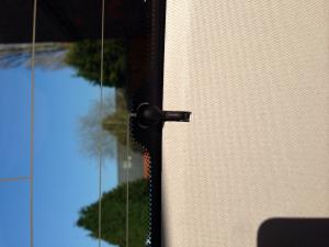

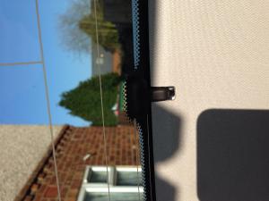

I have the two tabs on the rear
[ATTACH=CONFIG]44[/ATTACH]
[ATTACH=CONFIG]43[/ATTACH]
However it would appear my FM signal is coming from the Ariel on the roof.
Quickly unscrewing this proved it
looking at that you have the bottom FM receiver there
so now you are going to have to remove the trim
and see what is behind there
you may just be missing the top receiver and a farkra cable
if that is that case it will be very cheep for you do to this
you may be missing the receiver marked MA.
