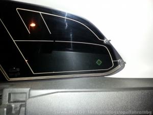

as you see of this picture i got from a German site it seems like there is FM and DAB fitted to the same site.. therefor the big confusion,, but it is only one thing to do and that is to tear down the boot of the stationwagon..

have taken some pictures of the right side, an as yoy see there is 2 fixings for the FM and DAB and a antenna. At the left side i could just see a little bit of a bolt, but as a feeling i got the right side as the good feeling..
and as it says in the EPC "Note: ONLY ONE OR MORE OF THE ABOVE POSITIVE OPTIONS IS REQUIRED TO BE FITTED TO VEHICLE"
so it can be as you mentioned at this is a Right/left hand side option

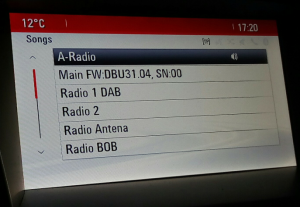

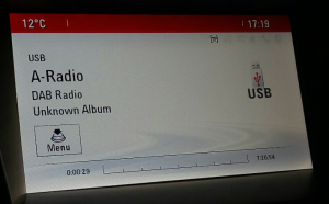

Today I received a test unit USB DAB+ (Dension).
Tomorrow on a way to work I will try more.
First impressions: working nice but with one remark, you need to wait almost 30 sec. when changing stations.
Maybe I will upgrade with K50 firmware (15 sec.).
