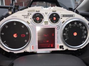

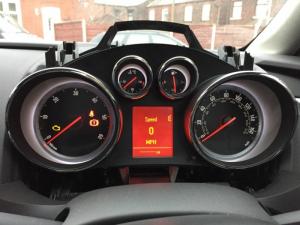

Okay cheers dude, will have a look now. Also the different options on mine are as follows:
[ATTACH]457[/ATTACH]
[ATTACH]458[/ATTACH]
[ATTACH]459[/ATTACH]
[ATTACH]460[/ATTACH]
[ATTACH]461[/ATTACH]

That looks so dark and dull around the dials lol

i see why you want to go ahead with this now
as rusty says there is only one way to find out sure he will help you work this out
and very odd looking with out the white dials

Just realised that the black plastic isn't just a blanking plate but it shows info in the form of LEDs lighting up bits of the plastic to show things like when the doors are open:
[ATTACH]472[/ATTACH]
Thinking it may not be as easy to remove and that the car may not be able to send info to the new display to show this there instead of on the LEDs .
What do people think?

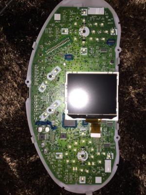

Well they arrived today and are in great condition! Such a shame I can't just swap mine out with these :( gonna spend a bit of time taking them apart so I know how to do it with mine without breaking anything! Ha
[ATTACH]473[/ATTACH]
Edit: Got it apart without issue anyway, broke one small clip but it was on the back of the dial surround and shouldn't need to use that bit anyway unless it turns out my current IPC doesn't have a blanking plate and I need to use this whole surround from my new IPC. One question though....how do I go about making sure the dials are back on perfectly so that they remain accurate...Or does it not matter how they go back on again?

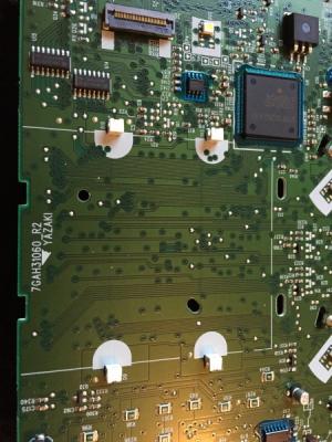

Only thing I'm thinking now is that the circuit board on my current cluster may not be the same as the one on the cluster I'm taking the screen from...The cluster i am taking the screen from appears to have 4 LEDs (can see the white squares in the photo below) which will illuminate the screen...surely my current cluster will have less and they will be in different places due to the smaller screen?
[ATTACH=CONFIG]474[/ATTACH]

can you put a picture of the whole circuit board up for me is this the new one and are you saying there is no display screen in it
#83
Sure will do. Yeah this is the new one and it does have the screen, just saying that it has those 4 LEDs in place for illuminating the screen (as will my circuit board) but because my old screen is smaller, the LEDs won't be in the correct place to light up the larger screen will they?
[ATTACH]475[/ATTACH]

possibly but it is not that hard to move them if needed
it looks like we need to see what is inside the other then i suppose

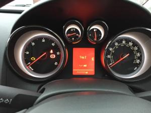

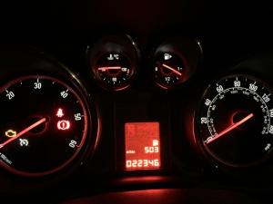

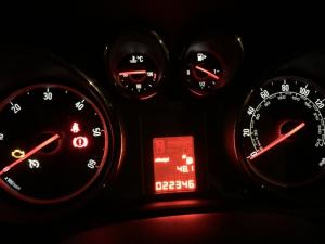

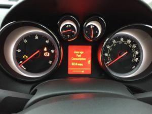

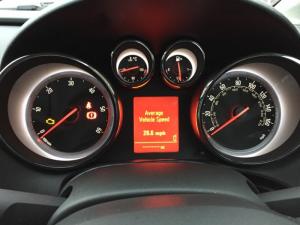

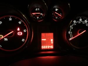

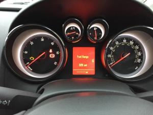

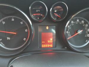

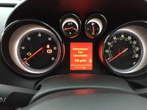

Okay guys here goes! Smile so I decided to just connect up the new IPC that I got after tucpal said to give it a go...and I was shocked by this but it worked!! All the info on the screen seemed to be there, this includes everything from my last IPC (with the correct info in there too) so average mph, mpg etc etc (see photos). The only issue is that instead of the cars mileage I now see "-------" I rang about a bit and someone said I should speak with Vauxhall. So I rang them and they said they can programme this in to work for me because this info is stored in the car itself! So I'm waiting to hear back as to whether they will do it next weekend for me.
Anyway the only other issues I seem to be seeing is that it tells me the washer fluid is low and also the coolant...I filled the washer fluid up but it's still saying this :-/.
Everything else works even the current MPH!
Pics as promised:
[ATTACH]477[/ATTACH]
[ATTACH]478[/ATTACH]
[ATTACH]479[/ATTACH]
[ATTACH]480[/ATTACH]
[ATTACH]481[/ATTACH]

Nice on mate, if you want to get rid of the low fuild messages you have a few options.
1. Do as Lewis did and fit a coolant tank & washer bottle with the sensor in.
2. Bridge the connections to stop it moaning.
3.Get the package turned off for them warnings.
I would suspect it will be a case of VX just plugging on the MDI and and possible an SPS and set-up and config or just re program it make sure they turn the extra info back on tho mate.
Have they told you a price atall?
