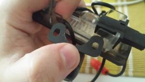

In order to retrofit it I got the right rear door light out to see how can I merge the camera with the light, I know its hard but its doable, I'm lacking the funds to buy an OEM original one Wink so why not start my first project on this car.
Things to be done :
  1. Fitting the camera into the light plastic.
  2. Fitting the monitor cables into the door upper panel (I think) !
  3. Finding the reverse wire and the ground to solder camera wires on them.

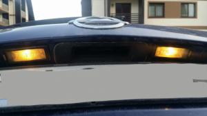

RE the boot button, I think I may have been wrong with saying it was in the bumper, the boot release button should be under the lip in the centre of the boot. Will look like the pictures below but no space for camera.
[ATTACH]419[/ATTACH]
[ATTACH]420[/ATTACH]
(Will undo from inside behind the trim).
RE cable routing best way is not the roof, remove the kick trim and you will find some trunking (by doors) that's the best way to run.

the boot release button. Just contacted a shop here but they didn't have the same part as you showed me in the pics. So I have to figure out another way to fit that cam.

Have a look at these pics please, can you tell me if I can modify something there to be put the camera on?
[ATTACH]423[/ATTACH]
[ATTACH]424[/ATTACH]
I would say the white plug forget about.
So you would need to ground both ends Tucpal has given you the details for that.
As for power to the screen there a few ways you could do this,
1. A switched live relay off the battery with an in-line fuse.
2. In-line fuse and run of the back of the 12v socket.
As to the wire for the reverse light here is the pin out from the back of the light, which will give the wire colour.
[Image: E43R%20Liftgate%20Tail%20Lamp%20Assembly...0Right.jpg]
As to modifying what you have will the camera fit on the black plastic so you can get it fixed? you would need to drill a hole to get the wires through.
