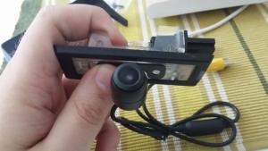

In order to retrofit it I got the right rear door light out to see how can I merge the camera with the light, I know its hard but its doable, I'm lacking the funds to buy an OEM original one so why not start my first project on this car.
Things to be done :
  1. Fitting the camera into the light plastic.
  2. Fitting the monitor cables into the door upper panel (I think) !
  3. Finding the reverse wire and the ground to solder camera wires on them.
[ATTACH=CONFIG]412[/ATTACH][ATTACH=CONFIG]413[/ATTACH][ATTACH=CONFIG]414[/ATTACH][ATTACH=CONFIG]415[/ATTACH][ATTACH=CONFIG]416[/ATTACH]

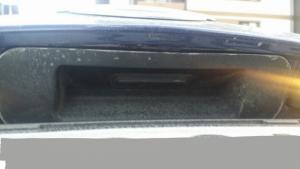

RE the boot button, I think I may have been wrong with saying it was in the bumper, the boot release button should be under the lip in the centre of the boot. Will look like the pictures below but no space for camera.
[ATTACH]419[/ATTACH]
[ATTACH]420[/ATTACH]
(Will undo from inside behind the trim).
RE cable routing best way is not the roof, remove the kick trim and you will find some trunking (by doors) that's the best way to run.

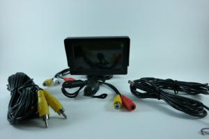

Just had a look at the pics and wiring you posted simple enough to wire up but is this wireless? If so you would not need to run the the long video cable from back to front.
Hey [MENTION=1]Rusty2009[/MENTION] , No it's not wireless. The monitor has 3 cables coming out of it, yellow, red, white. The Yellow is for signal, the red is for power & the white I dont know!
Camera has two wires also red and yellow, same as monitor but without the white one.
I was trying yesterday to start them in my house but I couldnt do it. I dont know exactly how to wire them. I tried :
1- A 12v 1A converter in the camera power cable while the yellow connected to the monitor. Nothing happened.
2- Connected the power to the monitor red cable while the camera was connected & nothing happened.
I think I have to fit it in the car for it to work. The thing I dont understand is from where does the monitor get power to work?
Camera gets it from the reverse cable, that I kmow but the monitor?

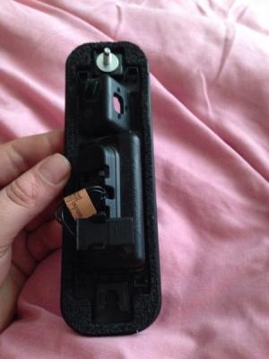

the boot release button. Just contacted a shop here but they didn't have the same part as you showed me in the pics. So I have to figure out another way to fit that cam.
Ok I'll have a another check on the white wire you did supply a ground didn't you?
the boot handle part number is 20907402 http://www.autovaux.co.uk/product/209074...lgate.aspx
£200.23 here in the UK, The one I have is not needed so is for sale, £25 plus postage which is £20 to Romania on a 10-11 day service.

I would say the white plug forget about.
So you would need to ground both ends Tucpal has given you the details for that.
As for power to the screen there a few ways you could do this,
1. A switched live relay off the battery with an in-line fuse.
2. In-line fuse and run of the back of the 12v socket.

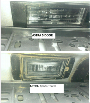

Has anyone found rear camera for sports tourer similar like for 5 door?
License plate light type.
(12:th-Apr-2016, 17:51:34)Jerry Wrote: Has anyone found rear camera for sports tourer similar like for 5 door?
Why would the tourer one be any different to the 5 door? The camera fitting replaces one of the number plate lights which I believe are a standard size. I bought my wireless reverse camera off ebay for 28 quid. Works fine.
The problem is because the ST number plate light is shorter.
Any idea?
I'm still searching rear camera for ST.

the factory camera is fitted into the handle surround, they come up on ebay every now and then.
I think zafira tourer has the same handle.
an image of the factory handle can be found here
https://www.*****.co.uk/cdn-cgi/image/fo...amera1.jpg
Best looking over the water for the handle and cam (make sure the cam has the little cable on it)
if that picture link doesn't work, the handle is shown on relpy #11 above.
