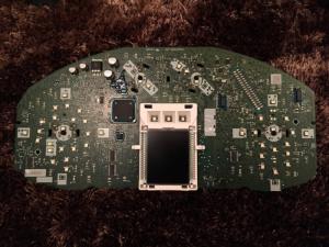

Also below are the photos of the IPC from my car with the small screen. The screen was never gonna come off because it's soldered to the board!!
[ATTACH]488[/ATTACH]
[ATTACH]489[/ATTACH]
well that is good know it can not be swapped over then

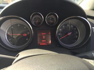

So not sure if everyone knows but i had the issues with my mileage not showing on the clusters, instead they showed "----" this was because they needed to be coded to work with my car.
Unfortunately as the clocks hadn't been removed from the last persons car properly they couldn't just simply be coded to work with my car. After weeks of trial and error with random garages who knew very little about vauxhall I finally came across someone called ***** who said he could do it.
So I spent the day driving too and from his house and he was able to code them in for me . He had to use his own software to manually update the code on the new clusters. Once he did that, all worked fine!!
[ATTACH]523[/ATTACH]
yes ***** is very good and glad you got it all working
Is that the guy over on ***?
yes
as always it can be done but the dealers really are not interested in taking the time to try and do it
but good work sheppy taking the time and risk to have a go and get it done
Yup! Exactly that tucpal, vauxhall rang me like 15 mins after they got my car and instantly said it can't be done...they didn't even bother to do anything other than what's in their manuals.
Cheers was happy to take the risk really and wanted to try and help others who may want to do the same as me...so if anyone has any questions, just ask . Thanks to everyone here who's offered me help and advice getting it working too.
***** was able to add the battery voltage and engine coolant temp to the display too
Would anyone have any idea where about the chip / eeprom is that stores the vin number on the instrument cluster, i can't seem to see if after opening it up.
Ignore the red circles but this is the board from my old, small screen cluster but the black chip on the left of the screen is the eeprom
Would imagine it would be the same on the large screen one (i can remember off the top of my head)
(30:th-Apr-2016, 10:54:52)sheppy1 Wrote: Ignore the red circles but this is the board from my old, small screen cluster but the black chip on the left of the screen is the eeprom
Do you mean the large one at the top left or smaller one in the middle?
Not sure which you mean mate bit I mean the one with the 4 silver pins in each corner that is right next to the top left side of the white screen surround
