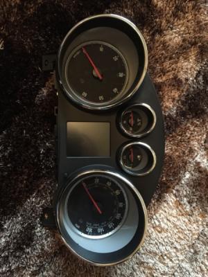

Well they arrived today and are in great condition! Such a shame I can't just swap mine out with these :( gonna spend a bit of time taking them apart so I know how to do it with mine without breaking anything! Ha
[ATTACH]473[/ATTACH]
Edit: Got it apart without issue anyway, broke one small clip but it was on the back of the dial surround and shouldn't need to use that bit anyway unless it turns out my current IPC doesn't have a blanking plate and I need to use this whole surround from my new IPC. One question though....how do I go about making sure the dials are back on perfectly so that they remain accurate...Or does it not matter how they go back on again?
Only thing I'm thinking now is that the circuit board on my current cluster may not be the same as the one on the cluster I'm taking the screen from...The cluster i am taking the screen from appears to have 4 LEDs (can see the white squares in the photo below) which will illuminate the screen...surely my current cluster will have less and they will be in different places due to the smaller screen?
