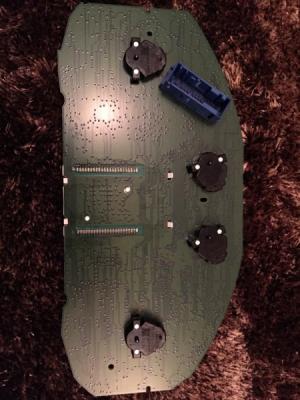

Also below are the photos of the IPC from my car with the small screen. The screen was never gonna come off because it's soldered to the board!!
[ATTACH]488[/ATTACH]
[ATTACH]489[/ATTACH]
well that is good know it can not be swapped over then

Would anyone have any idea where about the chip / eeprom is that stores the vin number on the instrument cluster, i can't seem to see if after opening it up.
Ignore the red circles but this is the board from my old, small screen cluster but the black chip on the left of the screen is the eeprom
[Image: ahhAVSS.jpg]
Would imagine it would be the same on the large screen one (i can remember off the top of my head)
(30:th-Apr-2016, 10:54:52)sheppy1 Wrote: Ignore the red circles but this is the board from my old, small screen cluster but the black chip on the left of the screen is the eeprom
Do you mean the large one at the top left or smaller one in the middle?
Not sure which you mean mate bit I mean the one with the 4 silver pins in each corner that is right next to the top left side of the white screen surround
