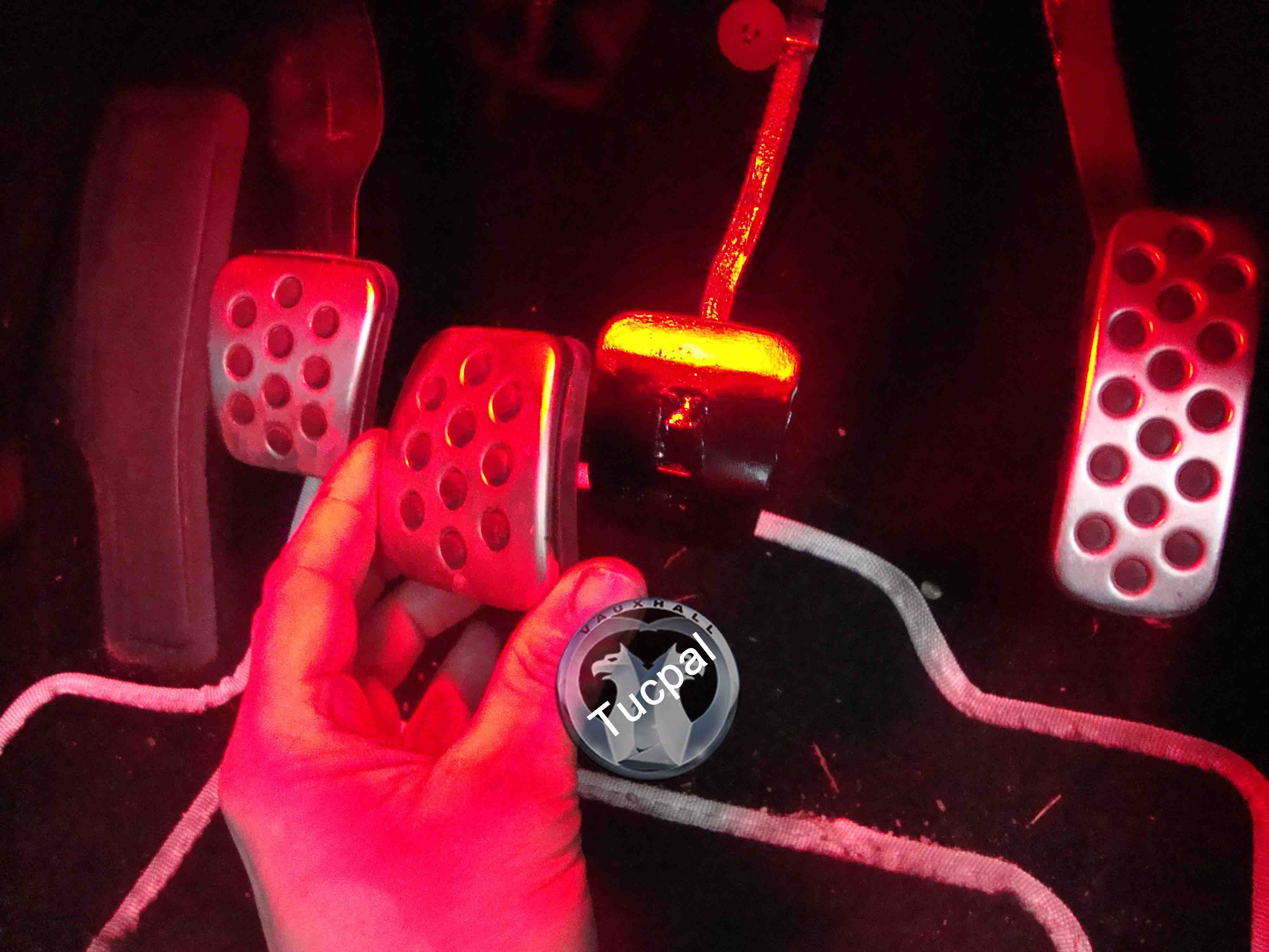

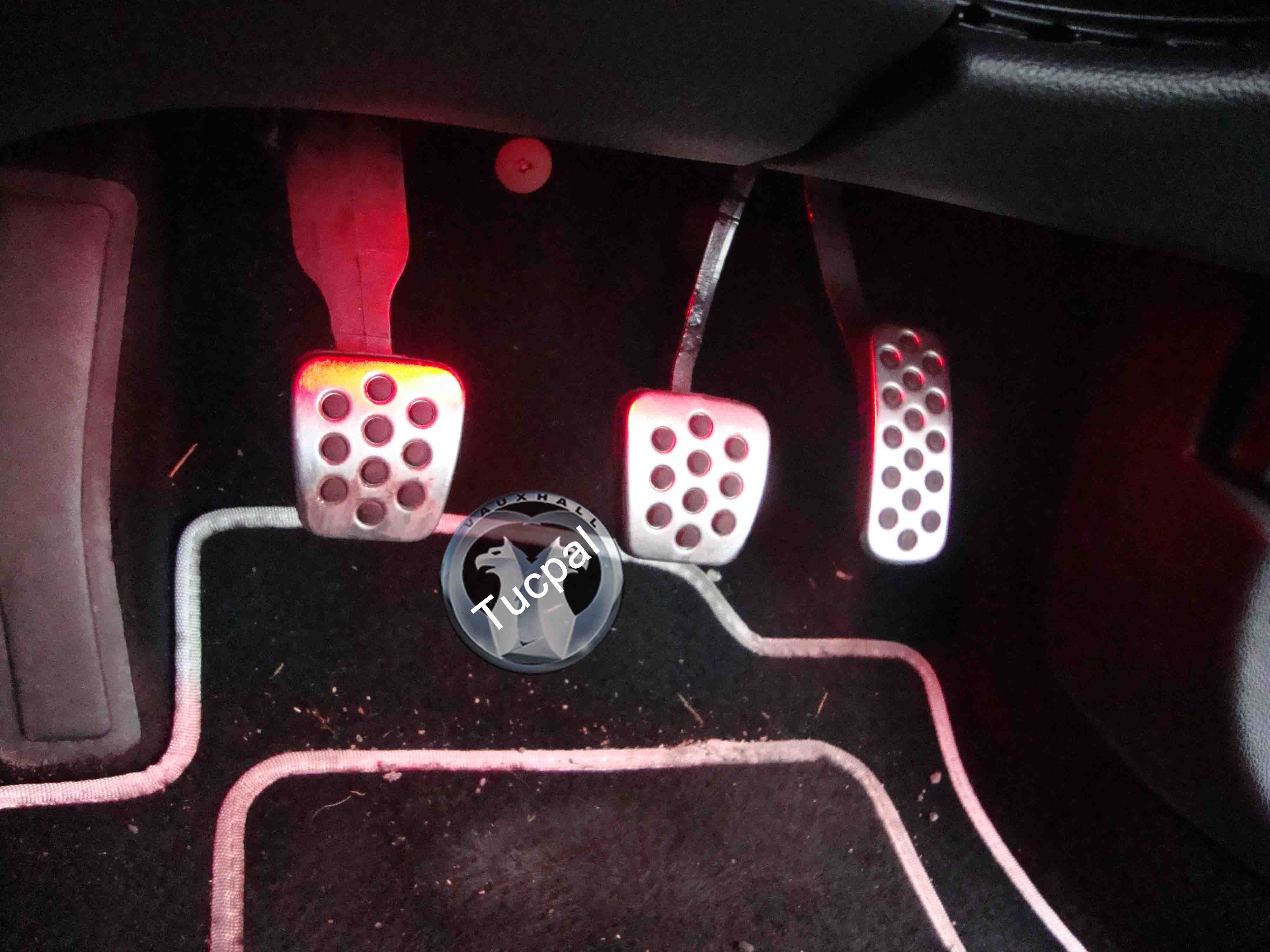

pedal alloy vxr covers
Alloy vxr pedal covers
A Real nice and Cheap easy to do Upgrade
The Alloy VXR Pedal Covers.
These Covers are Genuine Vauxhall Alloy Covers
Found on the Insignia VXR
they have never Officially ever Been on the Astra J
but they do fit the Astra j and the GTC.
Part numbers
Clutch Pedal... GM, 1901778
Brake pedal... GM, 1902778
accelerator... GM, 1901780
Do not but Astra H ones.
there very simple to fit A 5 minute job
just pull the old ones off
and Put the new ones Back on.
And the Results look Amazing
these Pedals Covers come up on eBay all the Time
Under the Title of Astra J or Insignia VXR or Sport Pedals
they sell on Average for around £30
For a used Set in very Good Condition
so Don't be Spending Stupid money
as said Above a 5 min job and Looks Amazing.
There are also Sets for the Auto Models but they are Rare
but they do Come up every now and Again.

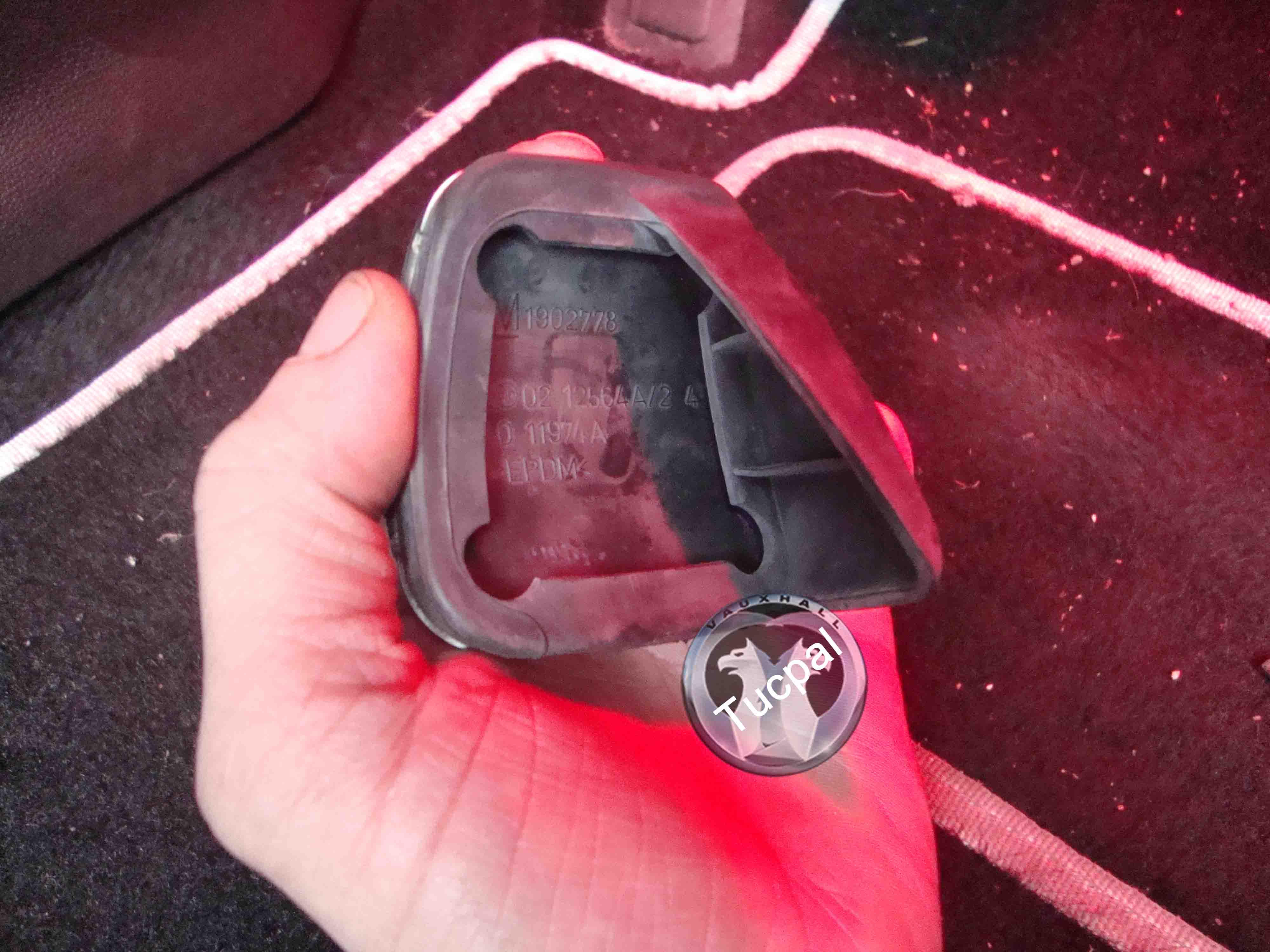

I've just got hold of a set of these but the accelerator one is a bit worrying as on the left top edge, the rubber sticks out slightly as theres nowhere for it to slot into, just won't sit flush. Is that normal?
