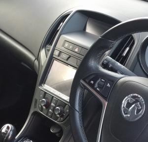

well here go's my install i have gone with a pioneer head unit avic f9880 dab
has all the bits i needed sat nav usb and so on
for the fascia im using connects2 parts
front speakers are jl c2 650 comps
rear speakers are jl c2 650 coax
sub is jl cp108
powered by a genesis profile 5 amp
so i have started on my install so far im not happy with the connects2 fascia as it seems a poor fit or does it need as they say a little fettling as where the ecoflex button is so seems to be pushing on the surround for the four line display this in-turn pushes the fascia away from the double din unit as well leaving a gap all the way round the unit
 the unit is all the way forward in its bracket so should sit flush with the fascia but doesnt
please could some one help out on this one or should i contact connects2??
Mine fitted properly with no issues at all I would contact connects2
I found the facia to be a bit awkward to install at first, still have to sort of push down so it fits under the original display bit at the top as well even now, but does sit flush
[Image: sig_zpsrr6dc7ua.png]
2012 Astra J 2.0 cdti sri
yep D92 your right its a push down and up to get it to sit flush under the original surround for the 4 line display ....so im a happy bunny again

I didn't have to push down and up with mine just started fitting from the top and worked my way round equal on both sides.

Does yours fit flush on top lip, I cant get mine to fit.
hi sorry i didnt get back sooner yes at the very top of the fascia it dips slightly but not enough for me to worry about
