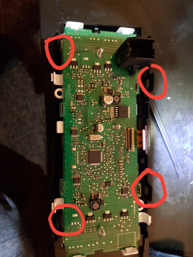

Next up, lift the dark grey retaining clip on the ribbon connector to remove the ribbon out. I don't recall it being necessary, however I'd rather undo it and be grateful, than leave it connected and rip it.
Then release the PCB & LCD from the remaining housing via the white tabs.

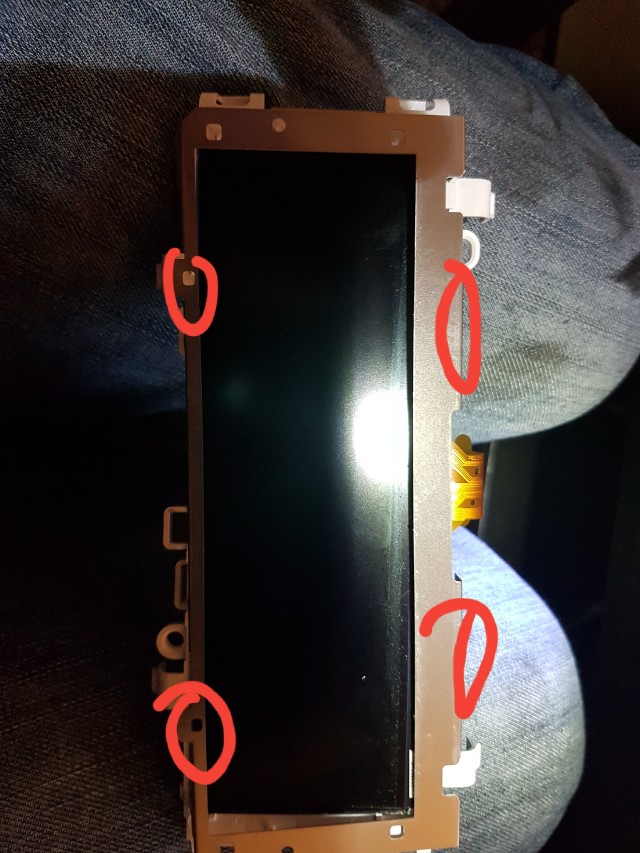

You can remove the LCD frame via the small tabs
Again, pay attention I don't think it is necessary but took the opportunity to give it a good clean.

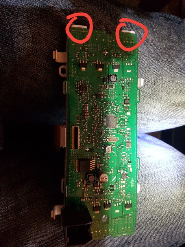

Now you can release the PCB via the clips at the top and bottom and viola:

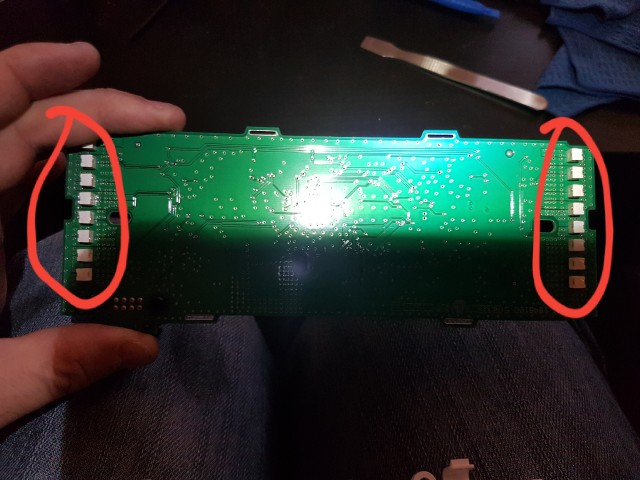

Happy go colour changy change
There are 16x plcc2 side view Lead's here.
I bought kingbright from Farnell UK, costing something like 12p each, far cheaper than the 99p each from eBay i could find!!
As with all electrical how-to I accept no responsibility for damage or problems you may encounter, please have your wits about you as identical models <> identical parts with Vauxhall/Opel!!
