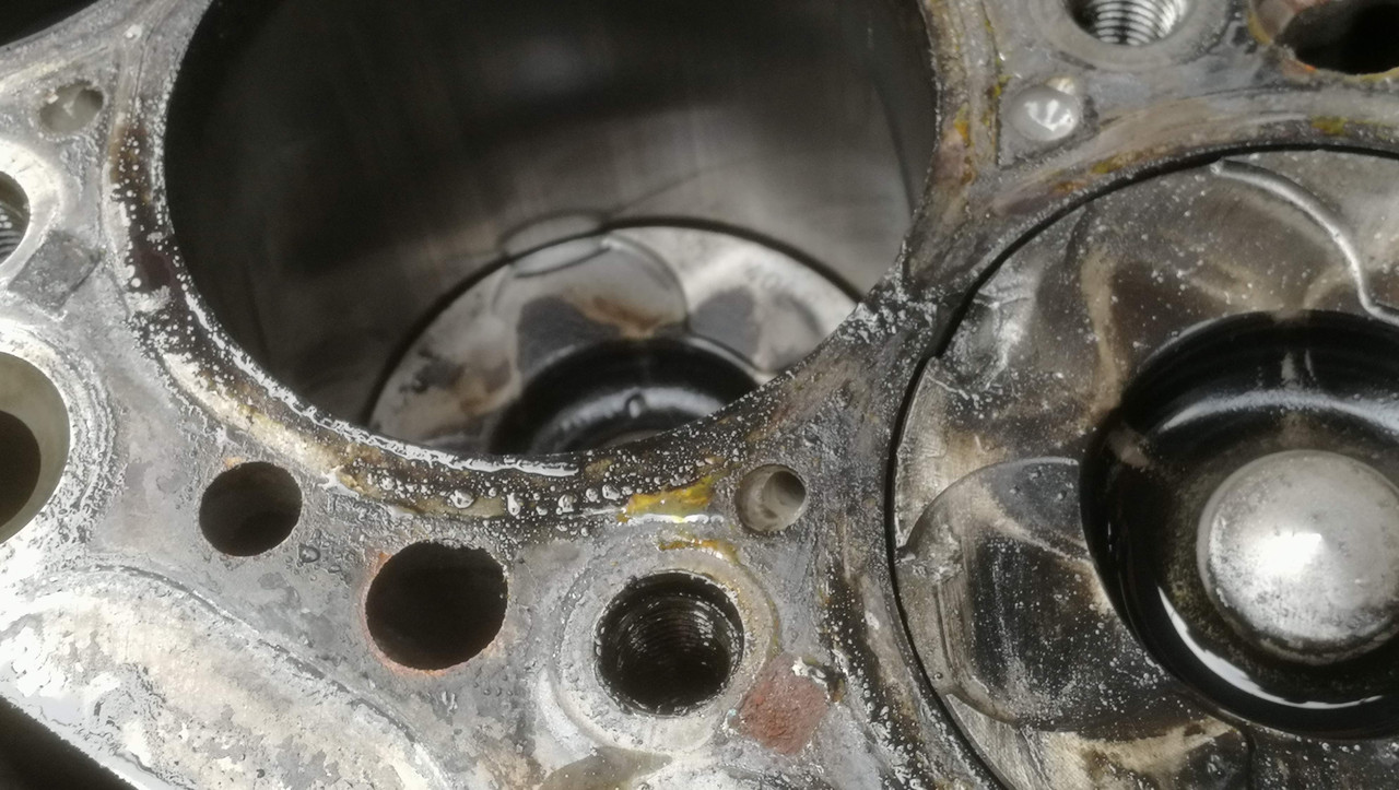

Here's the pics of the damage done
Do you think a wee drop of Araldite might effect a temp repair
Poor engine........
no not araldite - it doesn't set hard enough, you need to use a two pack chemical metal

classic blown head gasket failure and continued running afterwards
It can be repaired, new piston(s), weld head, skim head, skim block
(26:th-Jan-2019, 09:59:24)vocky Wrote: classic blown head gasket failure and continued running afterwards
New engine would be cheaper and quicker by sounds of it lol.
