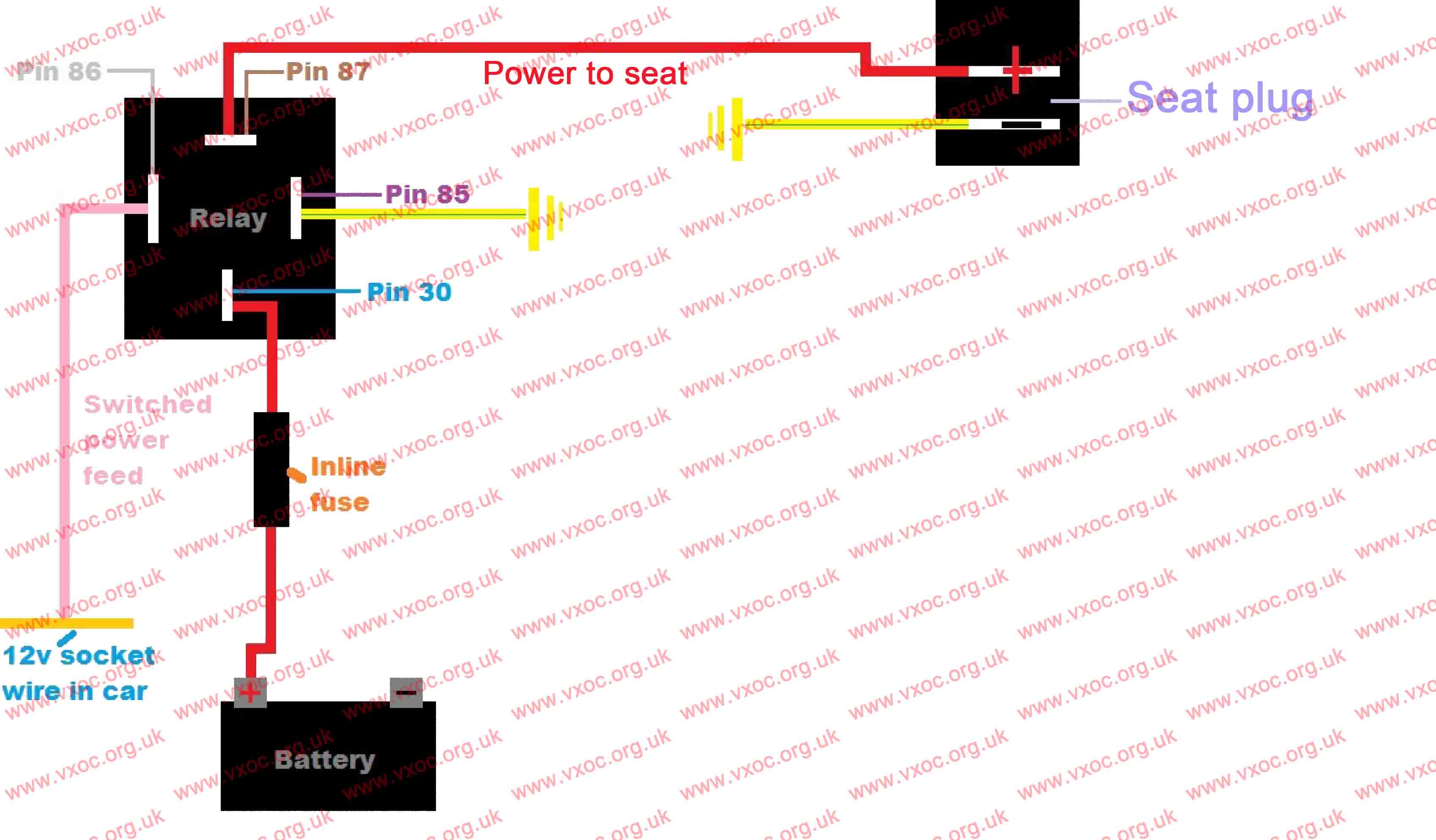

I've fitted a hidden gig lighter behind the glovebox which is ACC controlled
Thanks didn't want to force it to much as think there's air bags in there I'll maybe have another go next weekend
Yes there is a roof airbag that runs along the top but just be-careful don't jam anything in behind apart from a couple of fingers at the top to help pull it.
Here's how I wired my hidden socket up if you wanted it done that way,
Thanks that's worth a look I did try to shove some cable down the a pillar from the top to act as a fish wire but wasn't stiff enough to force all way down to behind the glove box I had originally planned to run the cable all the way back to the cig lighter socket and use a splitter but your way much better then not got loads of plugs and wires
