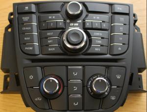

I'm having a problem whit installing a Android radio in my Astra J (2011) instead of my original radio CD500 (whit navigation). I know that a CD400 model or a CD300 model has almost the same middle console like a CD500 model. The only thing is a difference in the wiring of the middle console and steering wheel functions. Now i'm trying to build this Android radio instead of my radio CD500 model and got it almost 100% working. The only thing what I'm struggling whit is that middle console will not power up whit tha Android radio.
See picture to understand what I exact mean. My question is does anyone know how I can make that work. I know that the radio is working fine whit a CD400 wiring model if you would replace it. The functinality of of the console has been build in the Android radio the only problem is that I need to know how to power up the middle console so that the buttons can function.
You can also see other pictures of my original screen connector. But there goes only one wire to that connector from the Android CANBUS system and normally that works for a CD400 model. So i hope if there is someone who can help me out whit this wire diagrams.

So did you find a solution to this? I m also interested in replacing my factory CD500 with an aftermarket one.
You need to swap wires around between the screen and control panel & also at the main radio plug.

That's great! So you just replaced CD500 button panel with CD400 button panel? You didnt use the CD500 wirebox with canbus that the seller sent you?
(13:th-Jan-2017, 22:22:51)DNT Wrote: That's great! So you just replaced CD500 button panel with CD400 button panel? You didnt use the CD500 wirebox with canbus that the seller sent you?
Wiring changes has to be made.
The cd400 is wired totally different to the rest you need to make your wiring match a cd400.
The cd400 buttons will then work, you can't make the changes and expect a cd500 control panel to work.

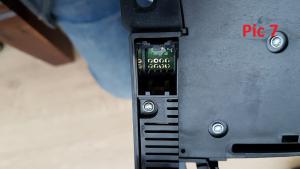

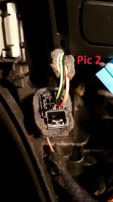

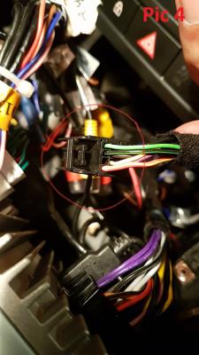

Hello I'am a newbie from The Netherlands. I seriously need help. My car is an Astra J GTC 2012 with Navi 900. After colour scheme update the unit crashed. So I replaced it with an Android 5.1 head init. I can use my Navi 900 control panel in combination with the head unit (the push buttons are not correct, when I push PHONE the NAVI app starts up). On Ebay I bought an used CD 400 panel.
I did the wiring as showed on Youtube (OPC Club Franken) :
https://www.youtube.com/watch?v=GvSAB8IKEXw
Unfortunately for me it did not work, the CD 400 did not light up.
Is it possible to re-wire?
Pic 2 :  Connector from Navi900 display (pink wire cutted in middle position)
Pic 3 :  Connecter from head unit
Pic 4 :  Connector from Navi900 (pos 2 connect to pink wire (pic 2)
Pic 6 :  CD400  panel connect
Pic 7 :  Navi900 panel connect

Problem solved , big thanks to Rusty2009
Glad you sorted this out using the above method. I m afraid there is no easy way to change what each button do

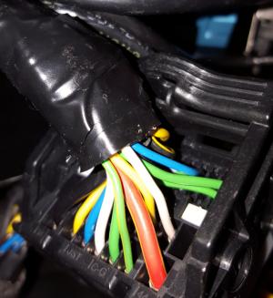

Well, now I'm exactly in the same position as OP.
Original CD500 panel lights up but all the button's functions are messed up (as expected).
When I connect a CD400 panel, then nothing happens (seems to be also an expected behavior).
Tried one of the tips shared here - cutting the purple wire from the display and connecting it to the second empty pin slot at the connector plug. Didn't work. Panel still doesn't light up.
Also, the new HU's wiring loom has a single purple wire with a connector. Another end of that goes to the CANBUS box.
On different pictures I've found over the internet, it seems to be connected with one of the display connectors. Looking more closely I discovered that it's exactly the same purple wire that I should cut to get the panel working.
[Image: 2019-11-24_18.56.00.jpg]
Conflicting information, so to speak.
