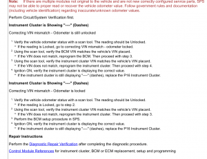

Hey everyone,
I've got an Astra J Excite with the lower IPC display. I wanted to buy a unit off eBay and fit it myself but ive done some research and undertstand it will need programming. I called vauxhall and asked if they could program it for me if i was to fit it and they said it's not possible, but I've read in the workshop manual that it could be programmed with the SPS programming device.
Hi so a dealer will not be able to do it as it officially can't be done.
I spent weeks figuring out how to do it so it is possible but not simple.
You can't just grab a set off ebay and think you can program it and it'll work there is alot more involved.
