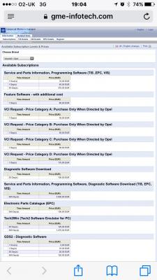

GM are now charging to supply VCI codes.
I emailed TIS help desk on the back of my old VCI request to see if it's now possible to obtain a VCI.
They've come back and said to contact Etac so I've sent off an email to them.
Ah some good news at last lol!
Fingers crossed
Sounds promising. Wonder why they've started charging?
No idea why they are starting to charge but here a screen grab of the price list.
Cheap then haha
Plan it right though you can book in say 5 at once as the cost is for 1 day but getting 5 people in one go never works for retrofits & if one person pulls out last minute the price then goes up.
