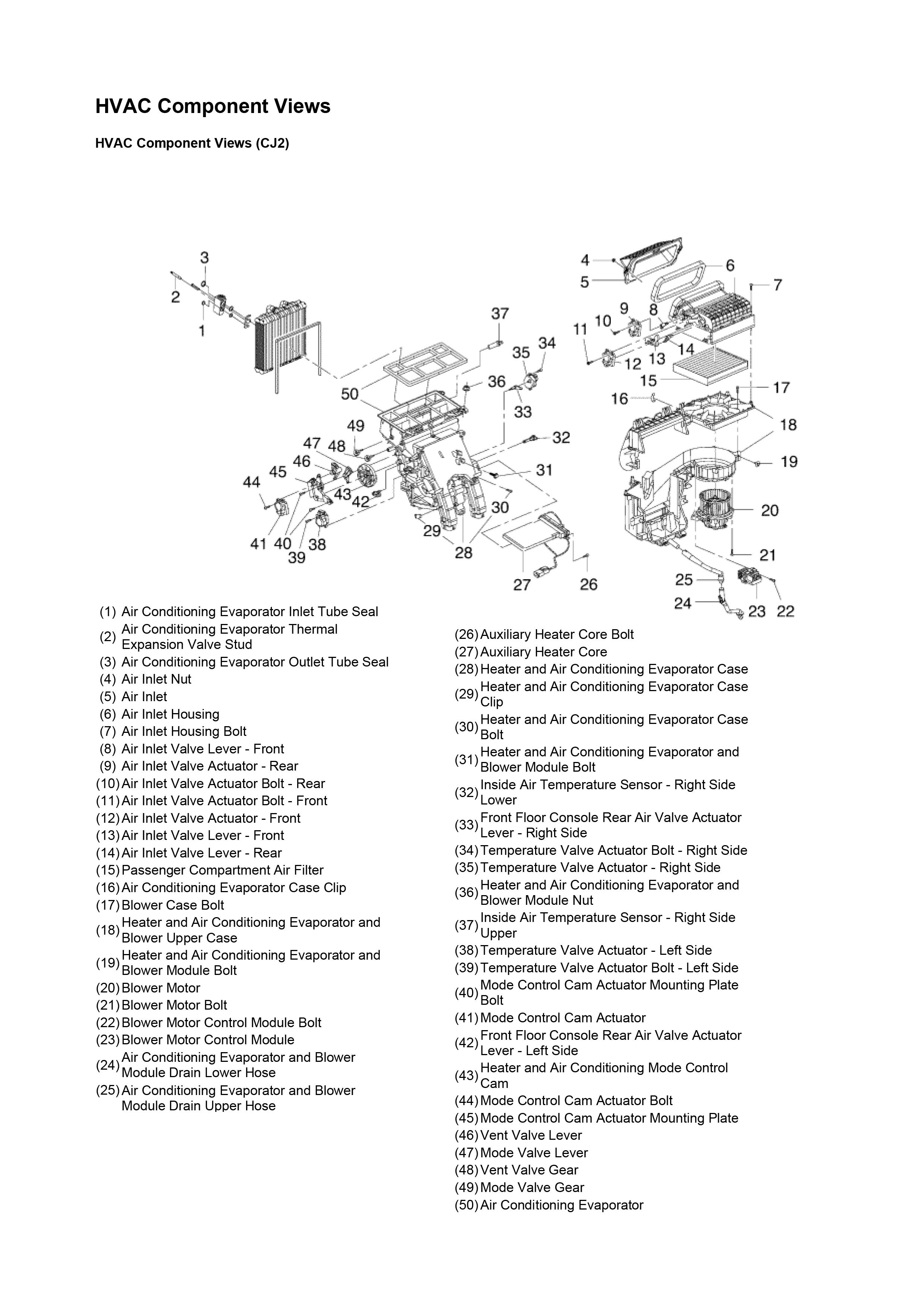

Hello, does any one know where the climate control sensor for Astra J sports tourer 2011 is located? Something strange is going on with my climate control. I have to set it up to 26 to start having some slightly heated air inside. No errors on the computer. Thank you in advance for the help.
Sent from my iPhone using Tapatalk Pro
Mines the same.
its in the dash somewhere I'll look it up on TIS later
I found that mine might have a problem after taking a ride on my friend Mazda 6. His climate control was set to 22 and it was blowing quite good warm air. And on mine on 22 it's blowing cold. But now it appears it might be not only mine like. Thank you for this Rusty
I have to have mine set at 26 before warm air comes out.
Here's the image only info I could on sensors. 32 & 37 are the sensors
[Image: Hvac%20view.png]
