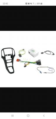

Hi guys...recently had fitted a kenwood 5020dabs stereo fitted replacing the current cd400 but still the steering wheel controls dont work and wondered if im missing something here,they fitted all wires etc but no joy!!! It was a basic cd400 with no Bluetooth or phone options so not sure if that makes a difference or not!!! If anyone could help I'd be ecstatic as really bugs me that I cant answer my phone
(4:th-Nov-2020, 21:18:13)Batesi19811111 Wrote: Hi guys...recently had fitted a kenwood 5020dabs stereo fitted replacing the current cd400 but still the steering wheel controls dont work and wondered if im missing something here,they fitted all wires etc but no joy!!! It was a basic cd400 with no Bluetooth or phone options so not sure if that makes a difference or not!!! If anyone could help I'd be ecstatic as really bugs me that I cant answer my phone
Which interface kit did they use?
When you say interface kit what do you mean by that?!? Sorry bit outdated in all this
Do you mean this? Sorry bit outdated in all this
Yes that's the interface, now comes the next question is it a silver box or black box with dip switches?
Have you held the SRC button down on the steering wheel to get into setting of the connects2 interface in there is an option to change the steering wheel controls to 6 or 7 IIRC, you will moat likely need 7.
https://www.youtube.com/watch?v=EeV5ShAagS0
I didnt fit it but can find out bout the switches,is there a difference...didn't know bout holding source button so will try that when I get home from work
(6:th-Nov-2020, 09:12:51)Batesi19811111 Wrote: I didnt fit it but can find out bout the switches,is there a difference...didn't know bout holding source button so will try that when I get home from work
Yes if it has dip switches they need to be set as per the installation instructions & depend on brand of unit fitted.
This is what he has said rusty
(6:th-Nov-2020, 13:20:34)Batesi19811111 Wrote: This is what he has said rusty
Which is?
Sorry picture wont post but basically what I've been given in the previous photo will not allow me to answer or make calls I need a separate connects 2 part/block about £100 to buy...just spoke to the company I got the kit and stereo off and they sell it seperstely ??‍♂️ hope that makes sense
Mine didn't have dip switches BTW
No worries yes that makes sense.
