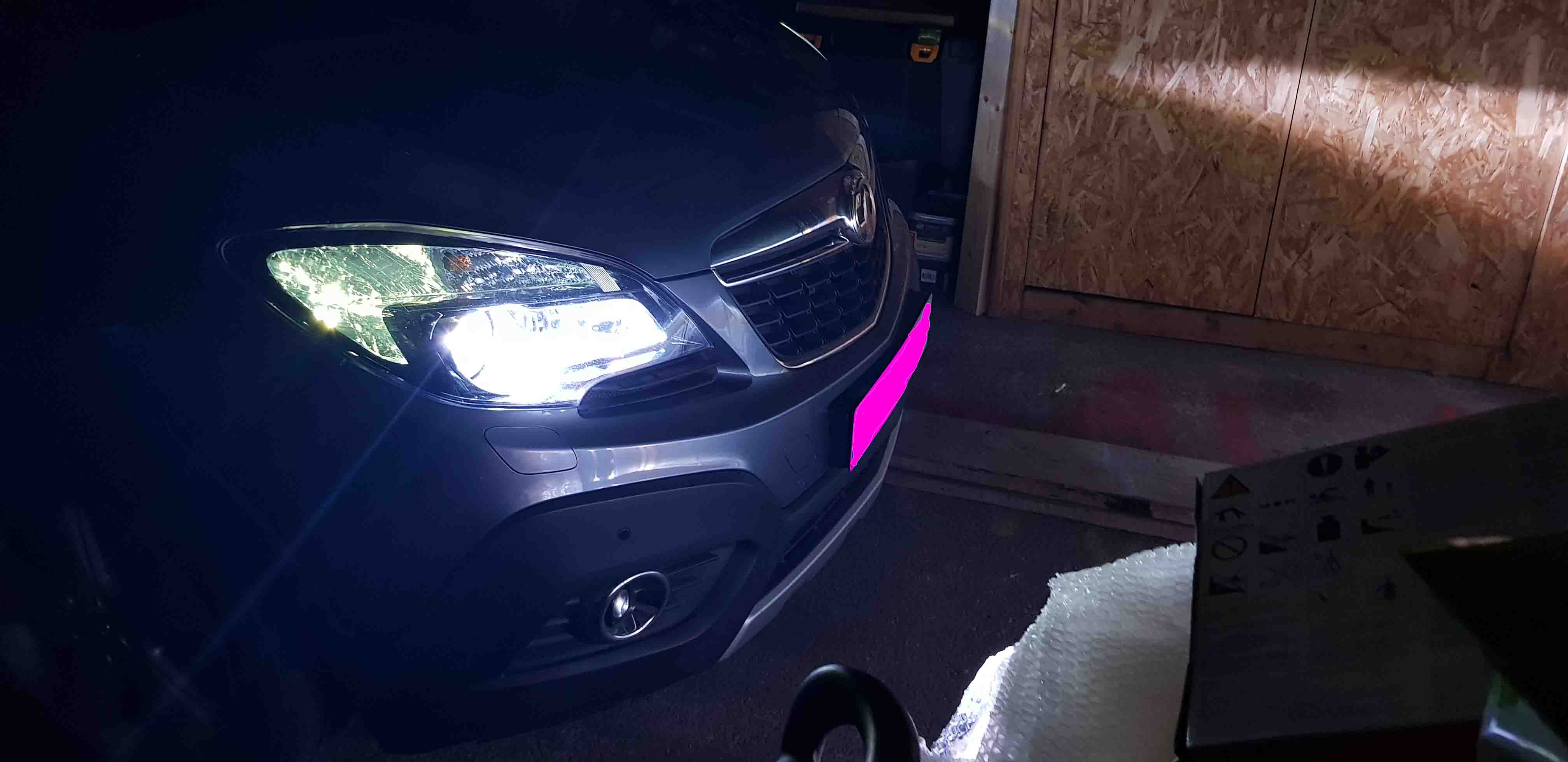

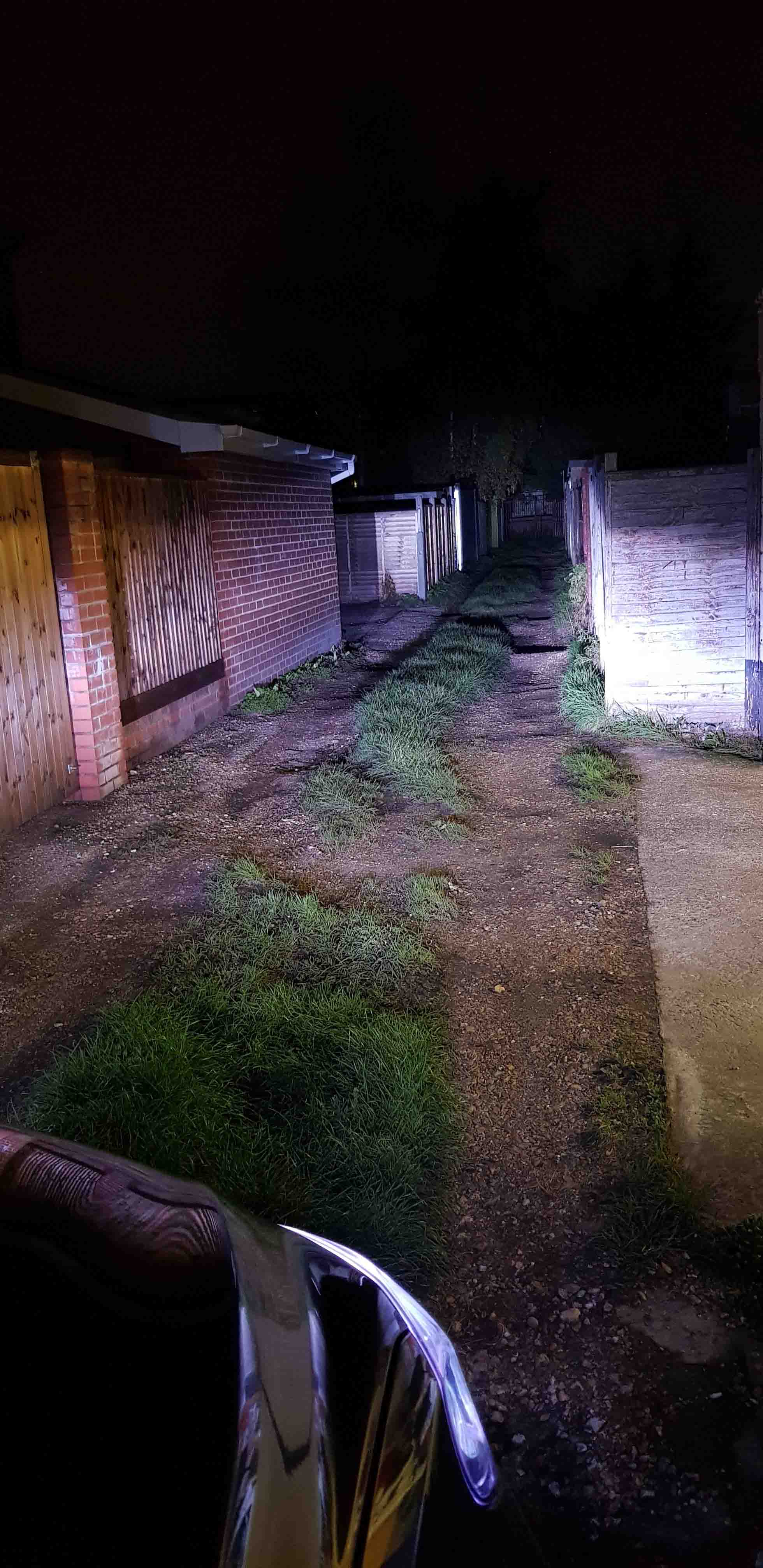

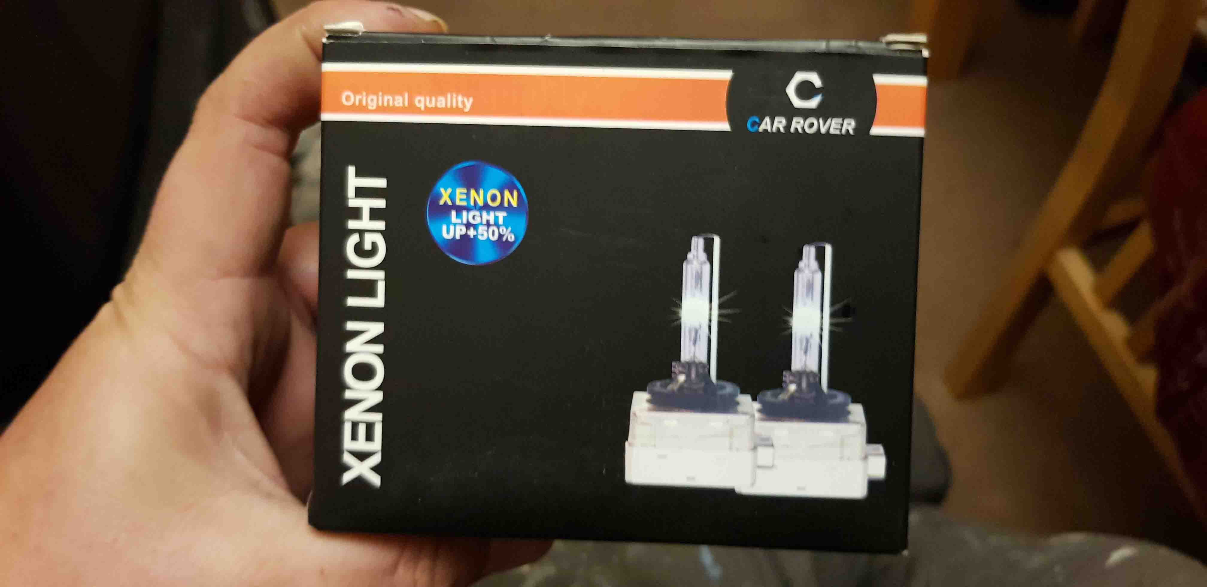

Next was to install some better D3S bulbs when swapping the headlight out.

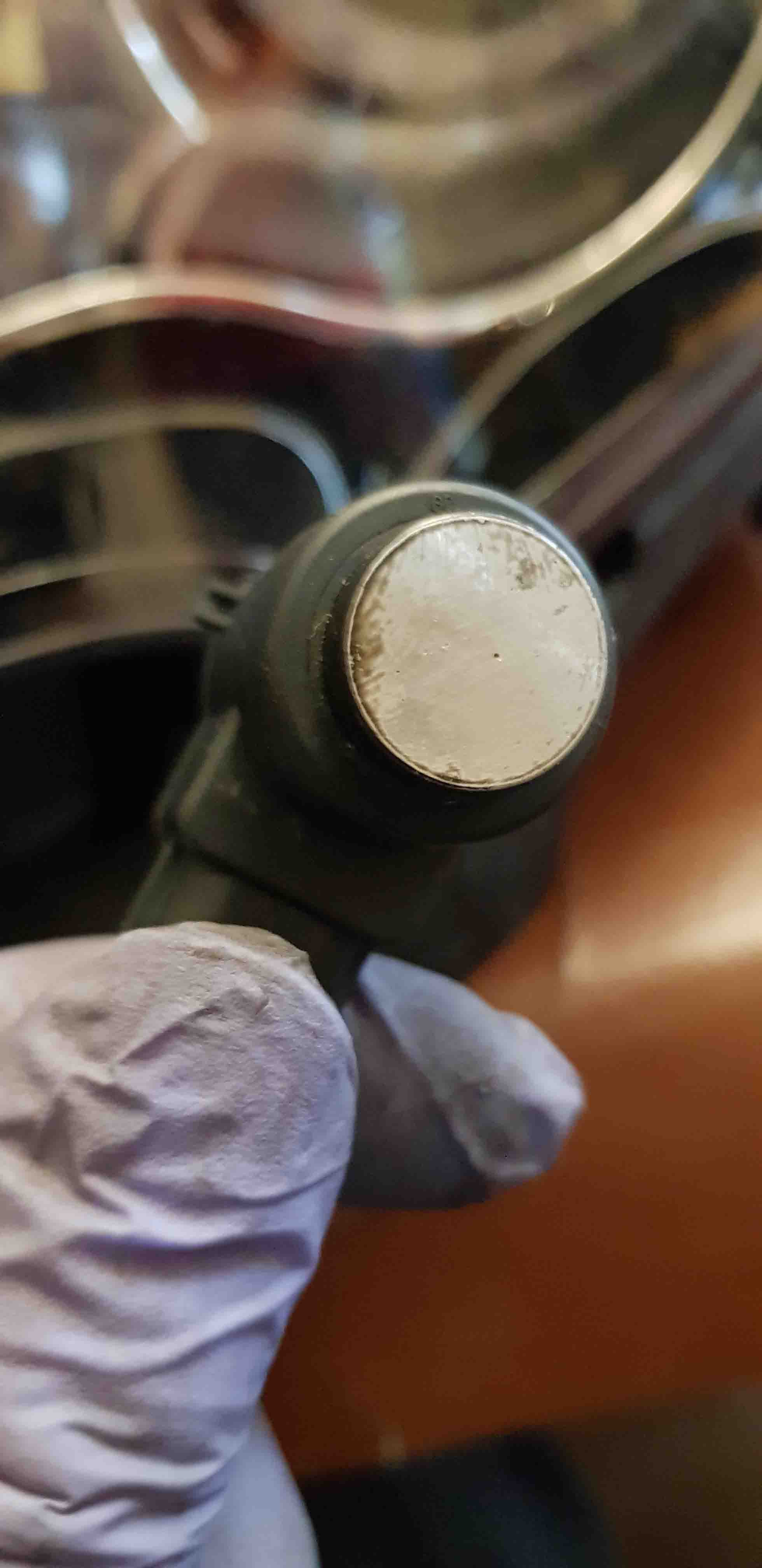

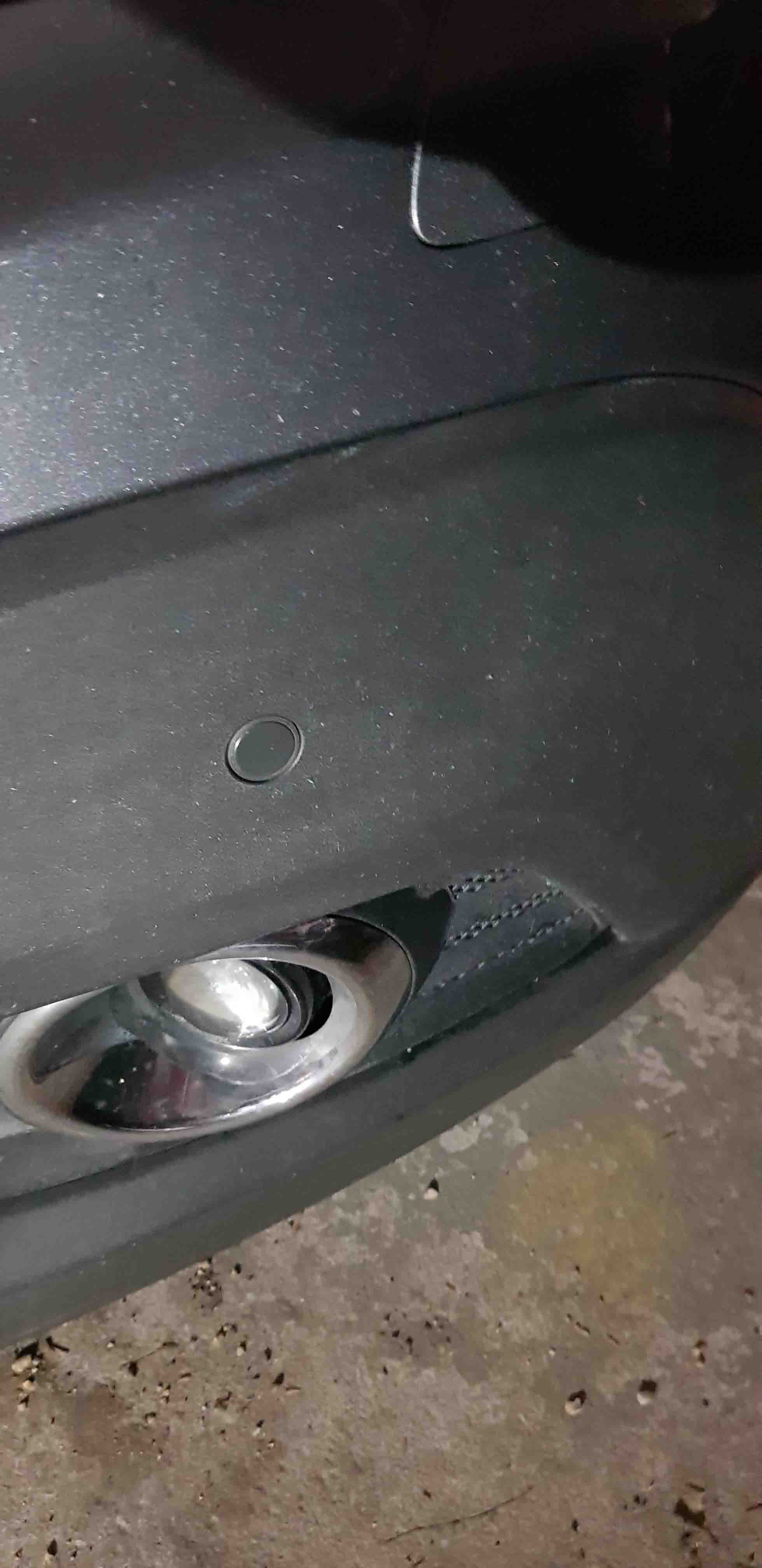

One of the parking sensors needed repainted as the paint had come off along with the primer.
[Image: 9.jpg]
[Image: 10.jpg]
[Image: 11.jpg]
[Image: 12.jpg]

The headlight bulbs are great he's even bought & fitted a set into the Astra after seeing how bright they were and well they light the road.

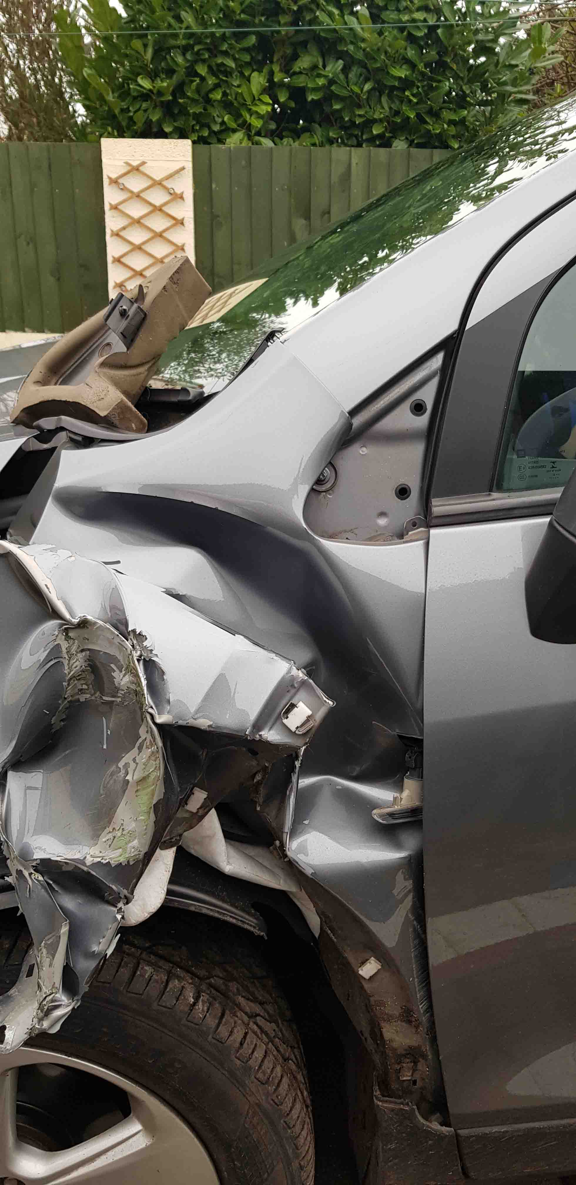

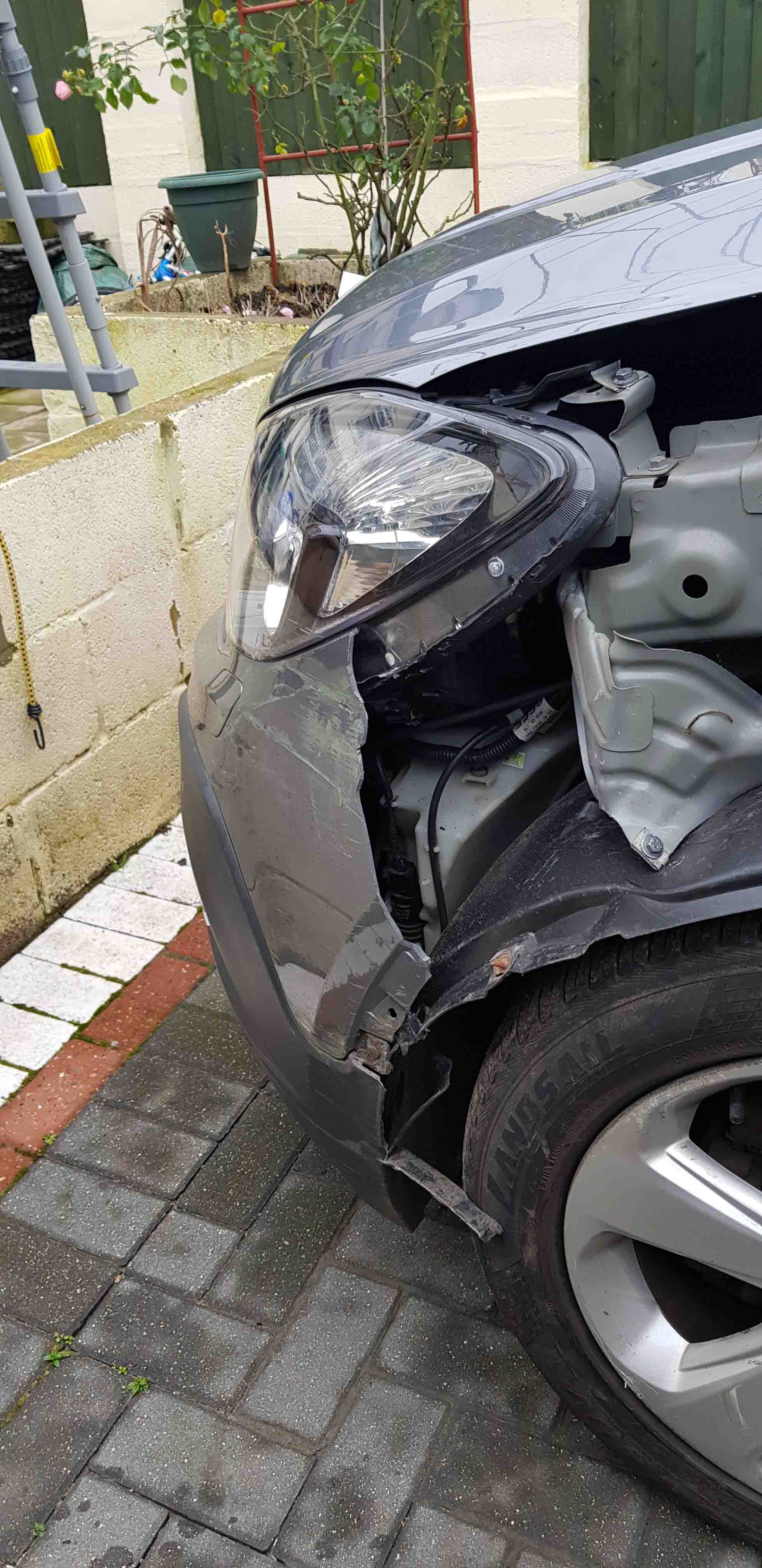

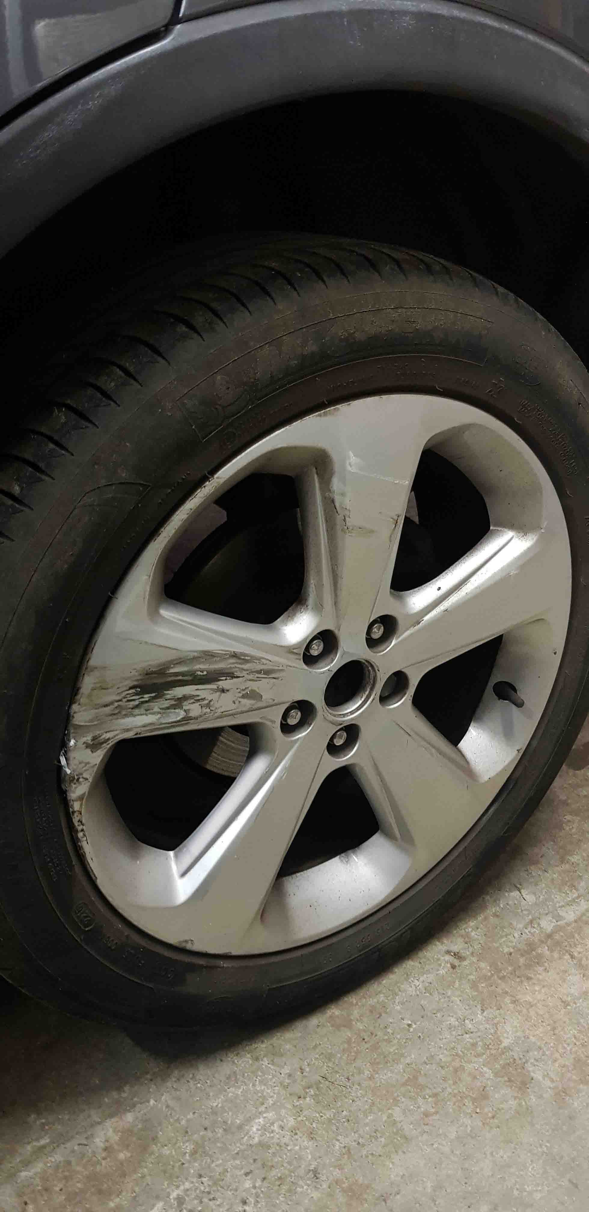

So here we are a video from the dash cam.

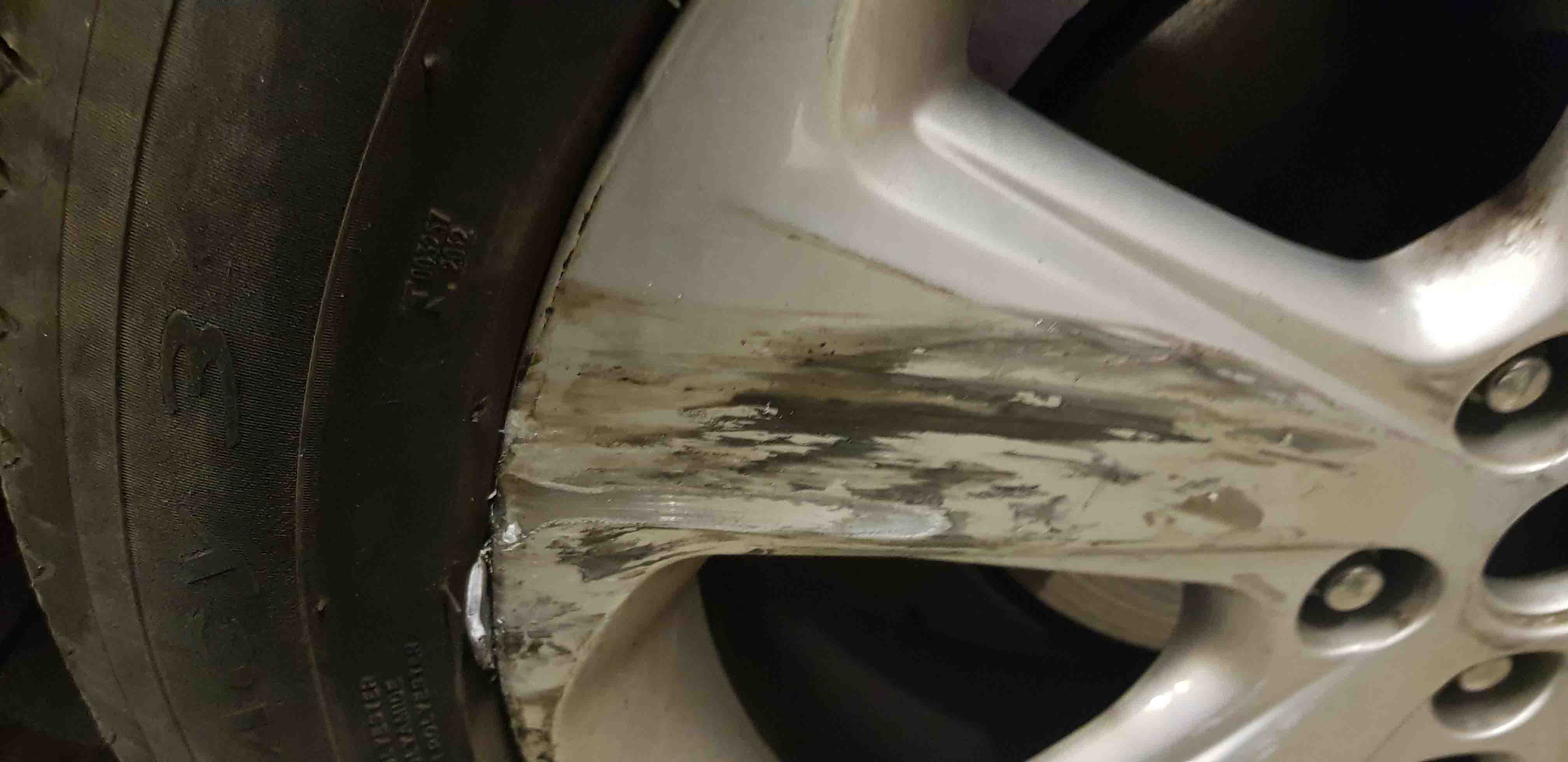

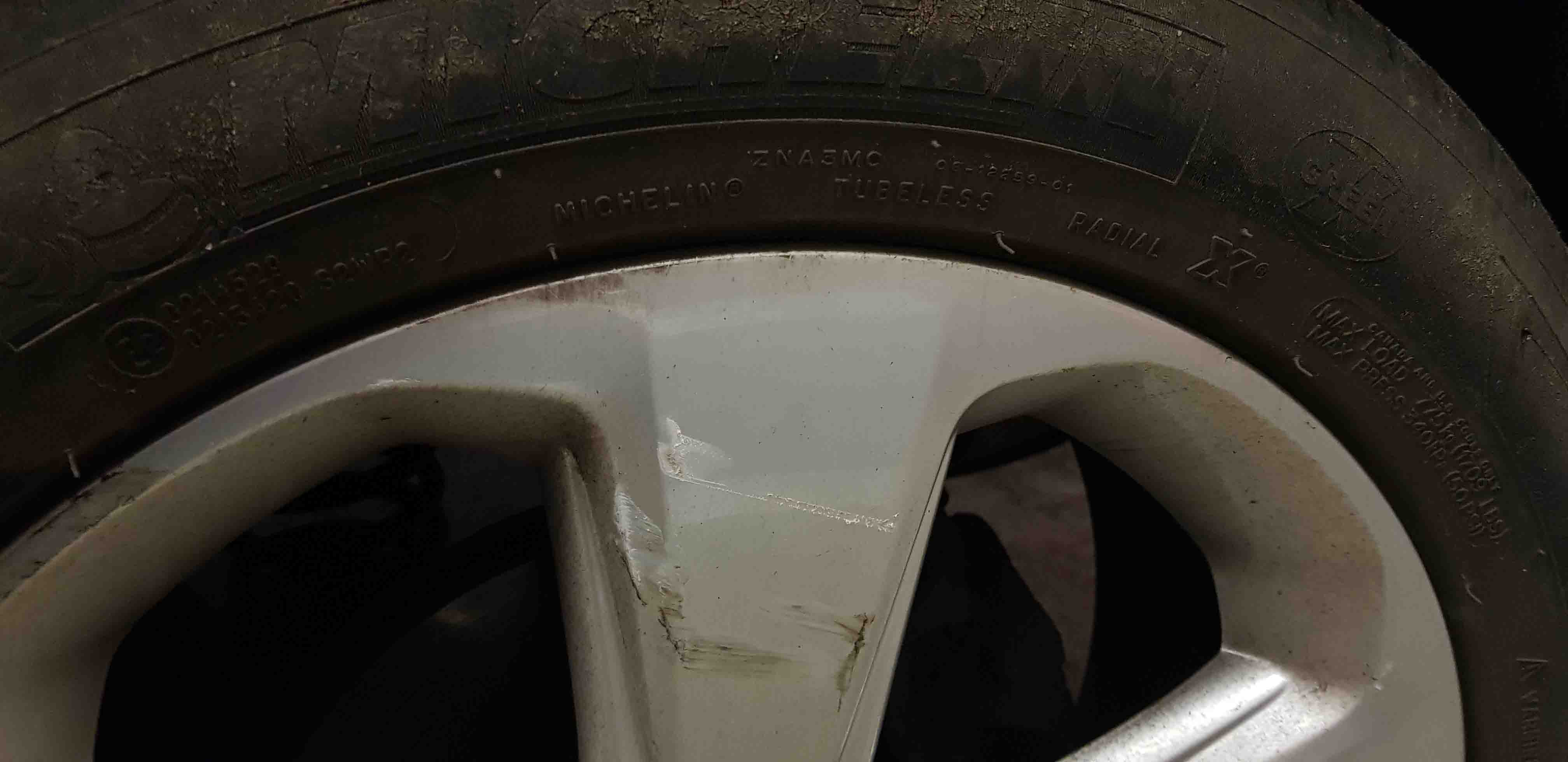

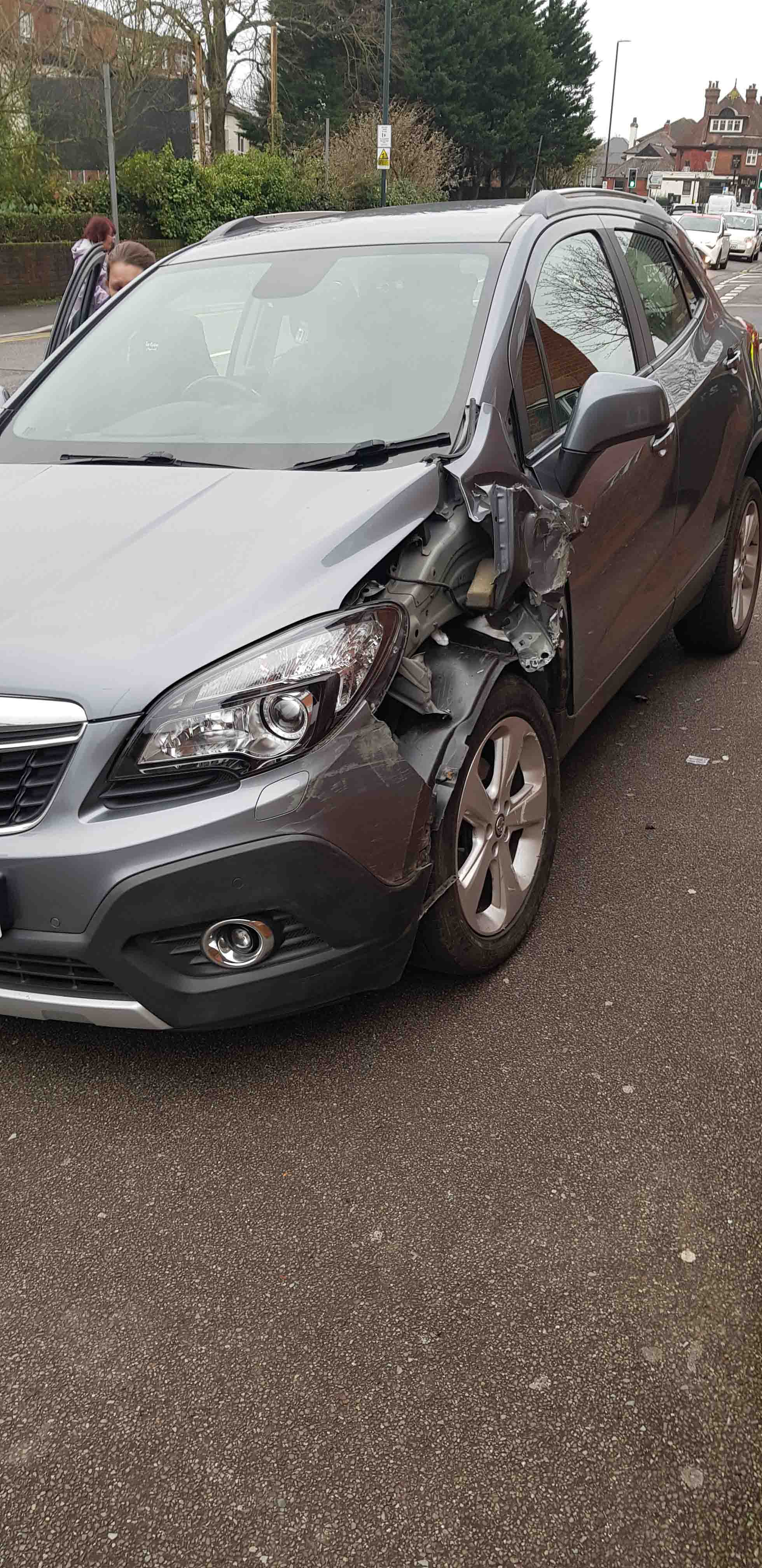

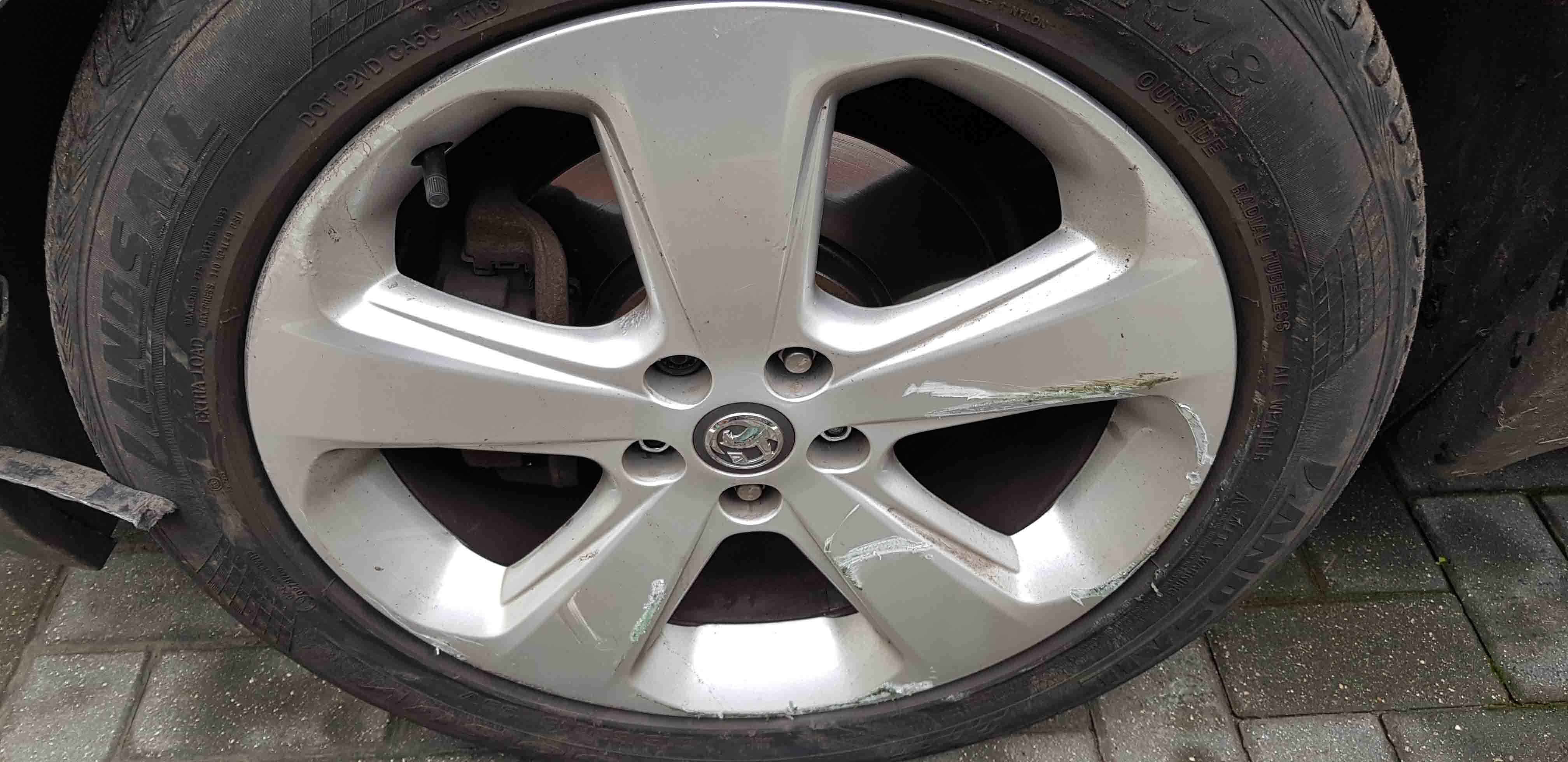

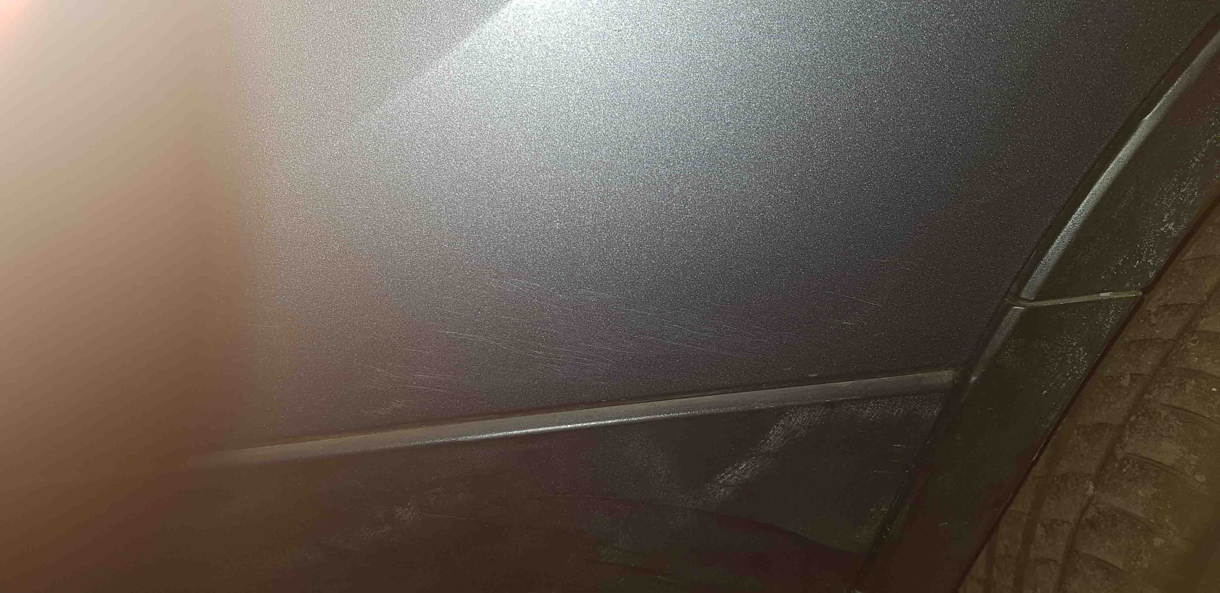

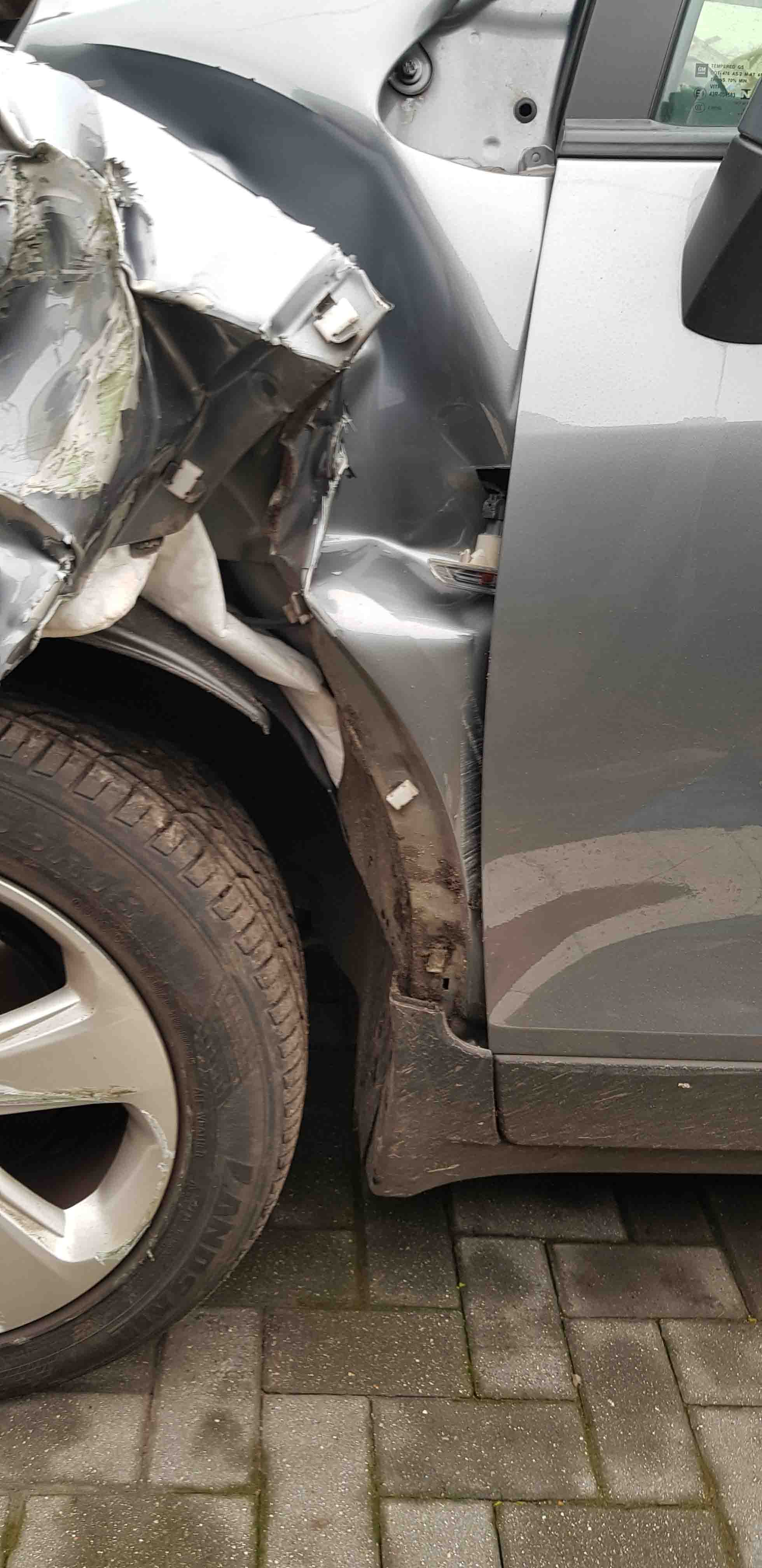

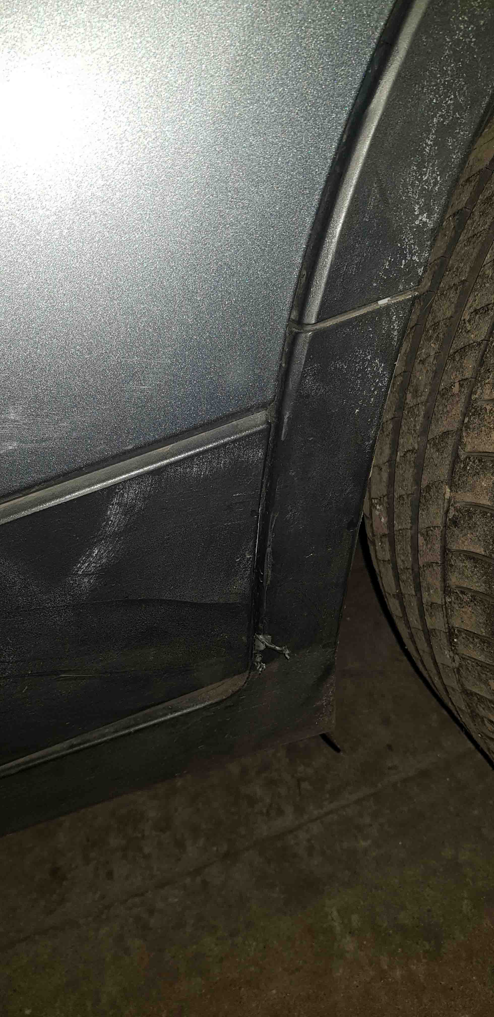

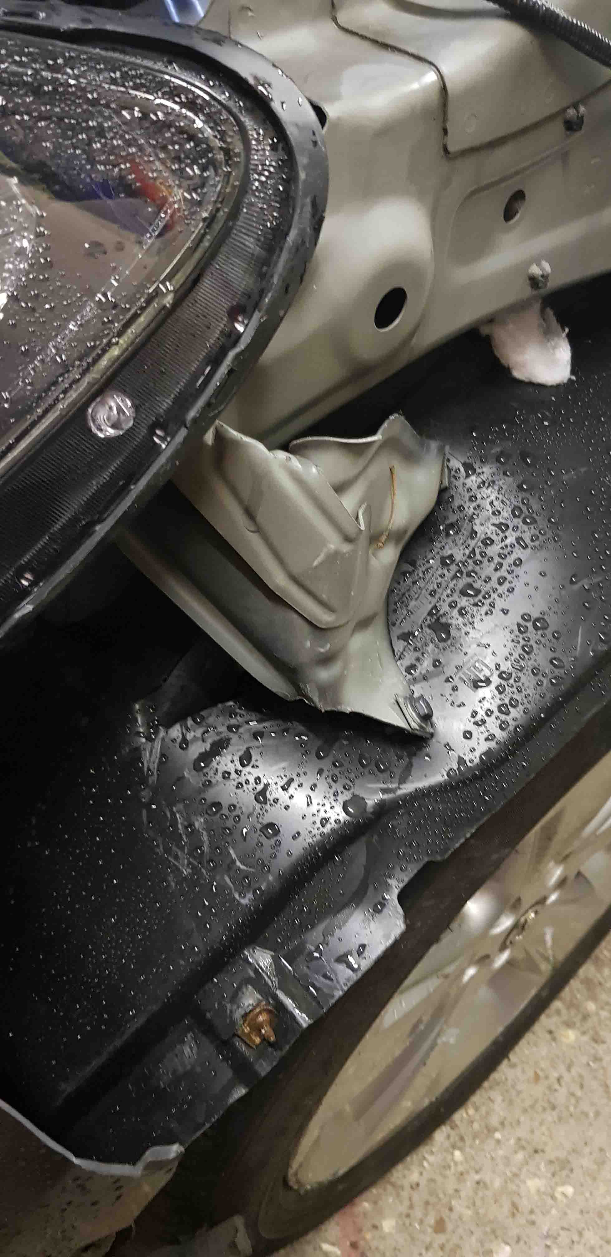

Pic's of the damage.
[Image: 1.jpg]
[Image: 2.jpg]
[Image: 3.jpg]
[Image: 4.jpg]
[Image: 5.jpg]
[Image: 6.jpg]
[Image: 7.jpg]
[Image: 8.jpg]
[Image: 9.jpg]
[Image: 10.jpg]
[Image: 11.jpg]
[Image: 12.jpg]
[Image: 13.jpg]

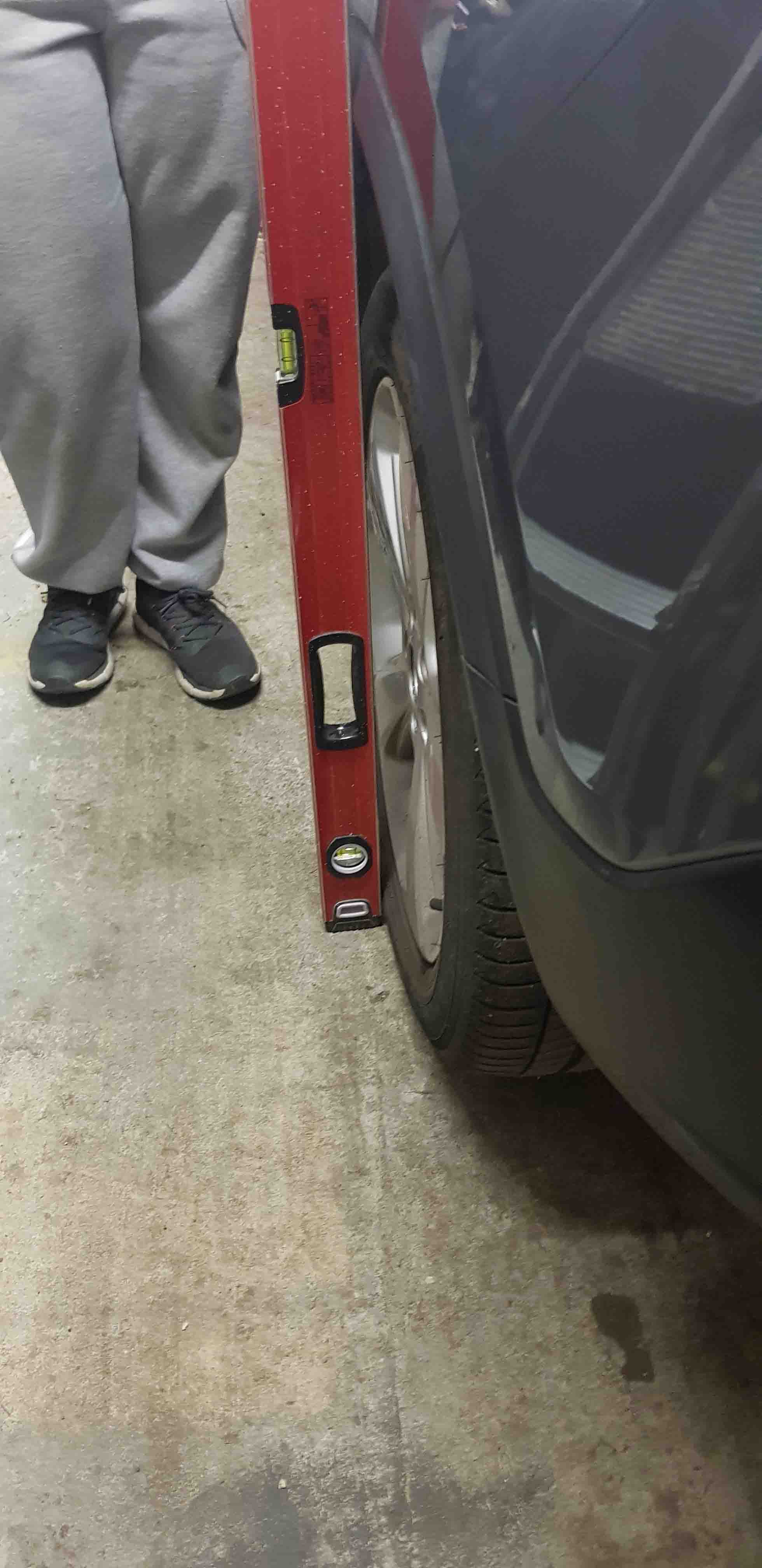

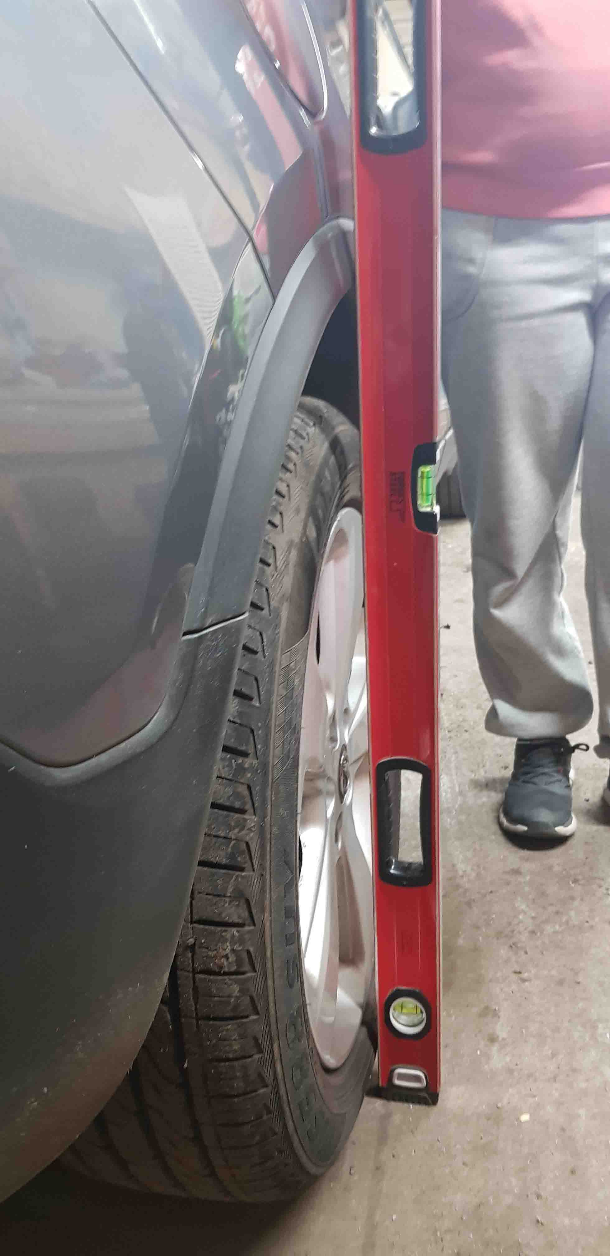

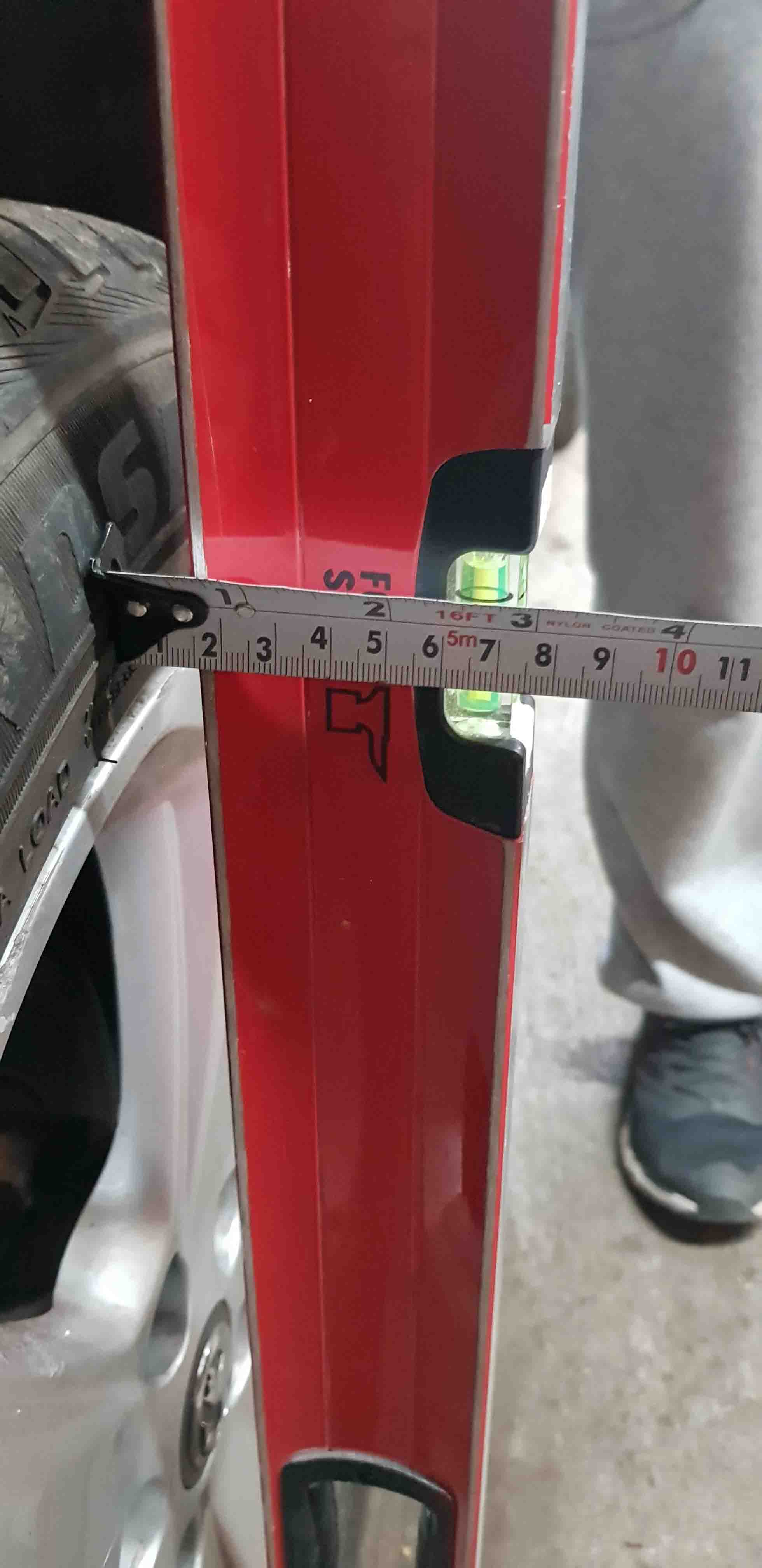

It doesn't look too bad to me
wing, bumper, headlight, dirtshield, 2x wheels and tyres and the headlamp mounting panel, plus a couple of side trims.

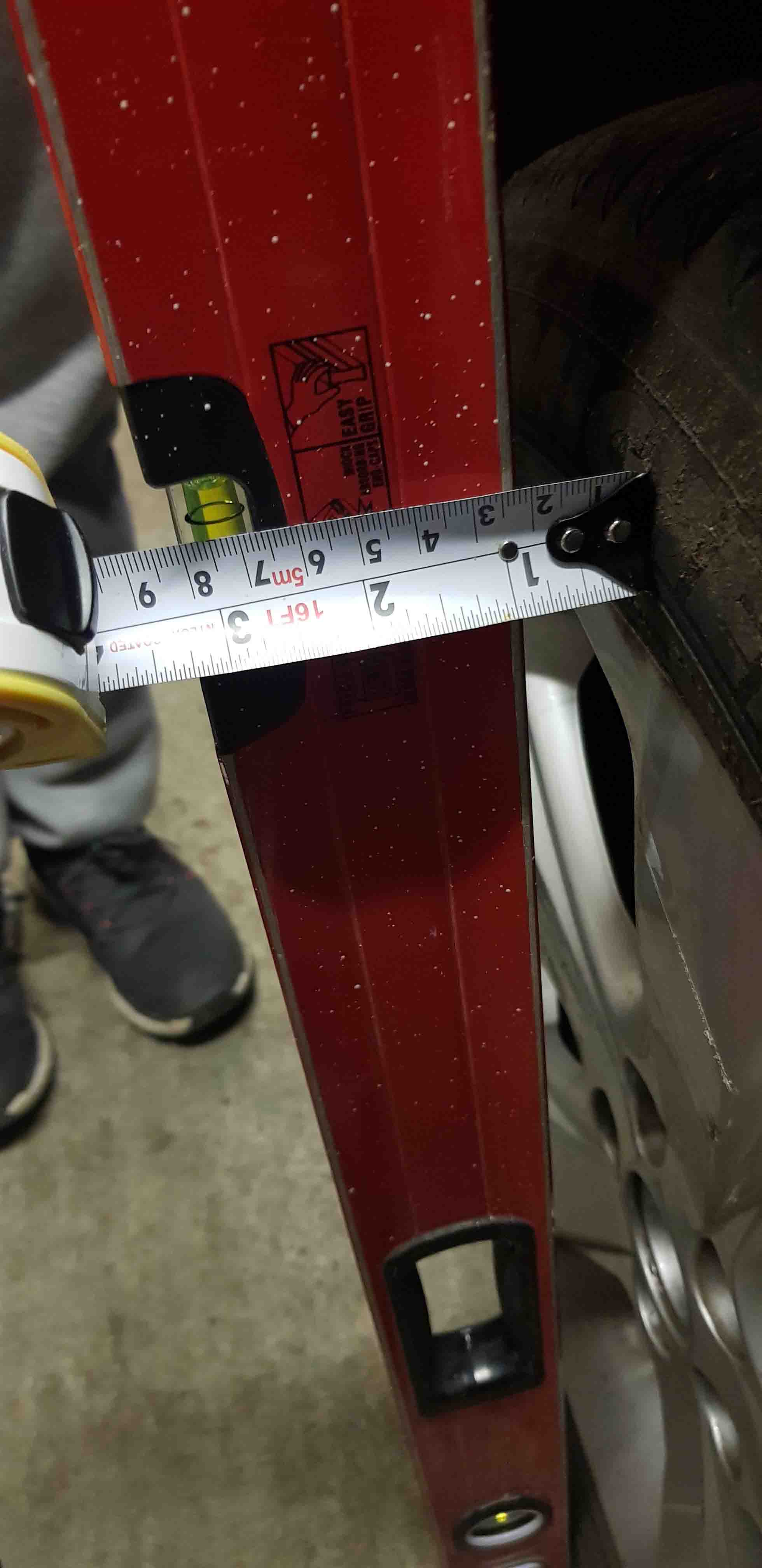

the difference in the camber on the rear wheels might be within spec, or may be due to a distorted wheel.
the trouble is the cost of the parts will put the repair around the total loss area.
the headlamp is a welded on panel and so the insurance engineer/assessor may decide its a cat S (structural repair)
but good news is that the accident wasn't your fault and so it should be claimed as a 3rd party with your repair being paid for by the other drivers insurance. Usually in this situation the "no fault" insurance company will insist the car is repaired (which means it won't be total loss)
and you'll get it back all nice and (like) new.
I've repaired much much worse.
I've priced on what I can see not inc paint parts roughly £1,500 (mostly all new parts too) apart from wheels as I would get a full set with TPMS.
Mrs want's it fully repaired tbh.
Well hopefully it can be fully repaired as it the good lady pride & joy
The car has been assessed and so far they are quoting £5,000 to repair they haven't carried out a geometry test or looked to see any running gear is damaged.
Apparently they need to make the car road worthy before carrying out the geometry test.
Spoke with insurance who are just as confused as I am with this because its standard practice to do a geometry test on car which has had a knock on the wheels etc.
anything over 3rd of value they need to ask the 3rd party insurance if they will are willing to repair.
we would always have to carry out a geometry check BEFORE the repairs as the engineers want to know total cost of repair.
as you say is £5000, they wont want to pay that and THEN findout it needs another £1000 suspension repair

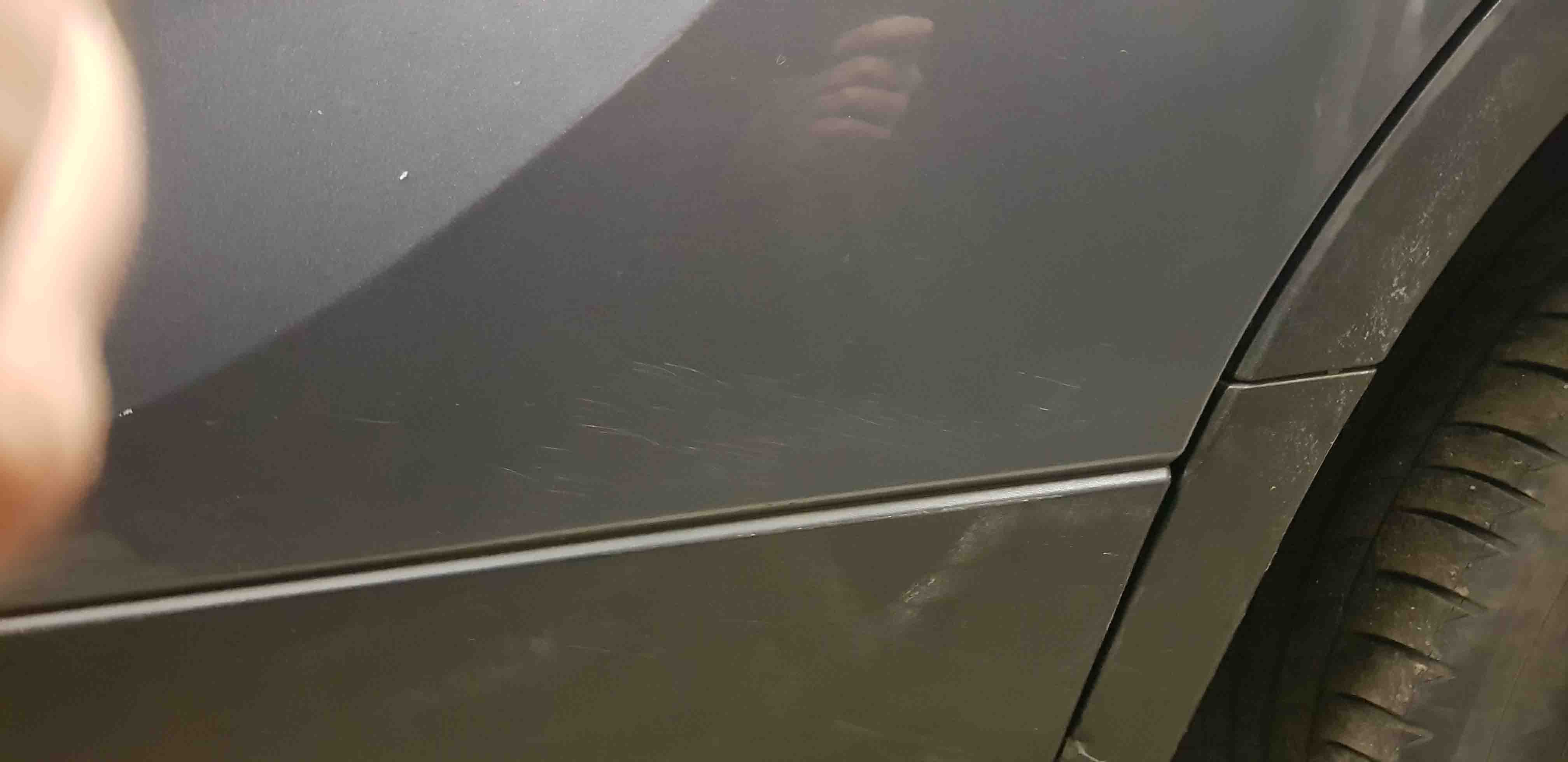

& low & behold while it's been parked somewhere some one has hit the back door putting a a dent in it and cracking paint no details left by offender.
thats bloody typical, no-one admits to that sort of thing now.
