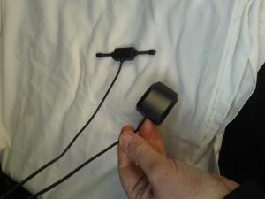

Aerials supplied, a GSM (mobile phone aerial) and the GPRS (satellite aerial)

In your Tracker box of goodies are the two aerials with cables. Now is a good idea to put a small sticker on each cable otherwise you may get them muddled up once you feed the cables up behind the door pillar. I used a small piece of sellotape with 'GSM' and GPRS' labelled on paper to identify them.  Don't connect them to the tracker just yet.

Take both your aerials one at a time and gently pull the roof lining downwards as this is where you need to hide your aerials. Push them inside the roof liner as far as you can reach without causing any damage to the roof liner. They should 'trap' themselves nicely and hold themselves into place once the roof liner is re-fitted. Now route your two aerial cables inside the left hand side roof pillar towards the fuse box. You may have to prise off the trim although it is possible to feed them through and they should appear near the fusebox. Be patient and with a bit of wrangling you should do it.

Connect the aerial cables you have fed from the roof lining to the tracker ensuring you have the correct GSM and GPRS cables connected to the correct terminals on the tracker as explained providing you labelled them correctly.
