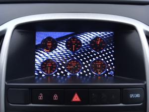

    I installed Torque pro app today and fitted a Bluetooth OBD2 adaptor and set it up. This is how it looks with a custom theme

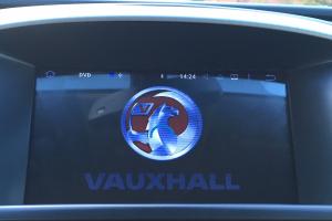

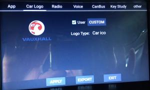

Mate, i just received this update from IceBox for B5754. >download from here<
i have already applied it, but did not had time to see what have changed. You need to place both .IMG files onto SD card and insert into GPS Card slot, then it should detect it and suggest you to update the device.
Spoiler alert: you will have all car logos for boot image

Hi mate.
I followed the link, downloaded the two files, copied to the sd card and installed onto my unit.
It said it had installed and re-booted and nothing had changed!! Don't know if I've done something wrong or if there is something wrong with the download?
How did yours go?

How did yours go?
It won't change much as this is not major update. I got this update from IceBox as i rised question about radio silent pauses as a option to try. Only visible change i could see was car logos selection for boot animation.
#29
I haven't got any more boot logo's just the 3 crappy Android ones. :(
#30
Tried it again and sorted it this time. Now got all the boot logo's, only problem was that it wiped everything I'd downloaded from the play store maps and all!! Never mind I've re-installed now can't see any more changes unless you've found anything?
