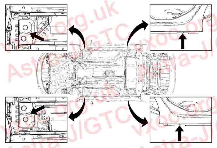

Vehicle Lifting – Frame Contact Lift
Front Lift Pads
When lifting the vehicle with a frame-contact lift, place the front lift pads on the underbody front
side rail outrigger, as shown.
Rear Lift Pads
When lifting the vehicle with a frame-contact lift, place the rear lift pads on the rocker outer
panel weld flange, as shown.
Vehicle Jacking
Caution: When you are jacking the vehicle at the front locations, be certain that the jack or the jack lift pad does not contact the front fascia, front fascia air dam, or the front fenders. If
such contact occurs, vehicle damage may result. When jacking at selected front locations additional clearance may be required for the jacking points.
Note: When you are lifting a vehicle with a service jack, block the wheels at the opposite end from which you are lifting. Use jack stands to provide additional support.
Front of Vehicle
When using a service jack under the front of the vehicle use one of the following locations:
Place the service jack pad in the same location as shown for the front lift pads.
Rear of Vehicle
Note: Place jackstands ONLY under strong and stable vehicle structures.
Place the service jack pad in the same location as shown for the rear lift pads.

Vehicle Lifting- Frame Contact Lift
Front Lift Pads
When lifting the vehicle with a frame-contact lift, place the front lift pads on the rocker outer panel weld flange, as shown.
Rear Lift Pads
When lifting the vehicle with a frame-contact lift, place the rear lift pads on the adapter, as shown.
Vehicle Jacking
Caution: When you are jacking the vehicle at the front locations, be certain that the jack or the jack lift pad does not contact the front fascia, front fascia air dam, or the front fenders. If such contact occurs, vehicle damage may result. When jacking at selected front locations additional clearance may be required for the jacking points.
Front of Vehicle
Rear of Vehicle
