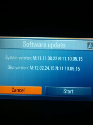

but when I tried to import POI the NAVI said that is the newer version of software on USB.
Now I was tried with firmware from disk, just to be sure, and I saw that is the same version of software (new one, from disk)

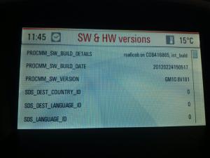

About theme update, atm i'm now at v181, if i update using a v208 theme file, does that upgrade my navi to v208?
