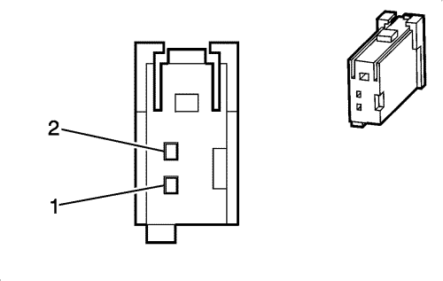

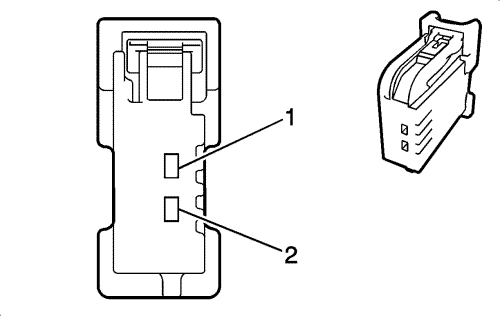

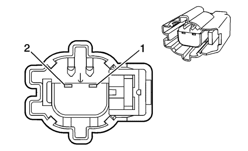

No totally the wrong connector for doors also wrong for centre dash speaker it may work on tweeters.
Here is the connector for doors 2-Way F GT 150 Series  OEM 19115644
Centre dash speaker  2-Way F 1.5-0.64 Series OEM 19115613 (U65), 19150056 (UQA), 19168545 (UQG)
Tweeter speakers  2-Way F 0.64 Series OEM 19115645 Service 13314093
Thanks for images, I couldn't find them.
I will try to use them for tweeters.
