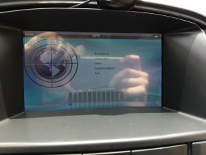

I have just installed my V5754 in my Vauxhall Astra J. Most things work nicely but the GPS Reception is very, very poor. The GPS info app shows that there is one sattelite it can reach and that is at 15 percent or 8 or whaterver. I don't really know what the pre-installed app wishes to communicate. I just assume that it's bad Wink.
Google Maps also can't find my location although I'm logged into my WiFi and I placed the antenna just below the windscreen.

When car vision installed my system 3 yrs ago, they said that they put the GPS aerial under the bonnet, just below the scuttle area as they said there is some issue with the Astra-J windscreens masking GPS signals. I suspect you have the same issue if that's where you've put your GPS aerial.
Unfortunately, my experience has found that the FM signal has never been very good on the Chinese units (mine included)
As for the GPS that’s a strange one as mine is on the dash just in front of the centre speaker and my signal is perfect.
Do you have any problems with the GPS on your phone? Could just be the area you are in?
I have the same unit and think the FM signal is better than my cd400, I have the GPS above my glove box and it works perfectly.
Just a side note anyone know how to set radio stations to the numbers 1,2,3 ect?
Move the GPS aerial. best place I've found is up by the roof light
Thank you all for your ideas and support!
I have already put the aerial for GPS on the car's roof and still there is no signal at all. My phone's GPS works perfectly. I asked Icebox for help and hope that they will answer me.
Maybe it's just the GPS aerial?

It sounds like the GPS aerial may not be attached properly or is faulty, especialy if it still doesn't get reception while on the roof. I have the B5754 (Android 7 version) and have the GPS in the where the centre speaker normally would be and get good reception.
(30:th-Jun-2018, 18:59:54)jw021979 Wrote: It sounds like the GPS aerial may not be attached properly or is faulty, especialy if it still doesn't get reception while on the roof. I have the B5754 (Android 7 version) and have the GPS in the where the centre speaker normally would be and get good reception.
Indeed it was. With a new antenna the GPS is working just fine!
