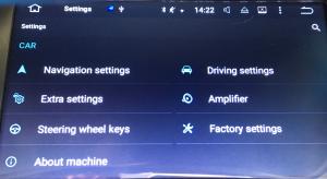

                    Now I've had a couple of days to get used to the B5754, I thought it would be an idea to post a few things I've noticed or discovered.
Quite a few of the functions seem to differ from the S160, the main one being the configuration menu where you can change the settings for left hand or right hand drive and the boot logo. On the S160 you have to dial ##0323 on the phone app to access this function, but on the B5754 it is in the "factory settings" in the main settings menu where it will then ask for a code which is "126". This menu then has several sub-menu's, a couple of these being "canbus" where you can change the handing of the car so that the correct door shows when opened, and another being "car logo" where you can change the boot up logo. Unfortunately there are only 3 logo's you can choose from and they're all Android one's so no vehicle one's are stored in the unit. What I did was copy some Vauxhall logo's onto my USB and chose the custom option in the car logo menu. What this seems to have done is rapidly speeded up the boot up time of the unit, the logo only flashes up for about 2 seconds then the unit is fully powered where before the Android logo seemed to be there for a good 10 to 15 seconds!!!
Another thing that happens is if you're say listening to the radio and you press the CD button on the dash, the Vauxhall logo now comes up until the CD loads which looks kind of cool!
My only disappointment at the moment is the USB port, it only comes with a bog standard male to female cable so I've had to remove the car one and push this one through the hole which is not ideal I believe the S160 come with the correct cable to attach to the cars USB port???
I've seen on a different post that someone has sourced a USB/Aux connector that can be retro-fitted in it's place so this might have to be the route I have to go down unless someone can source the cable that comes with the S160.
Other than this I've found the unit really good and a lot better than the one I had in my Astra H although this was running WinCE not Android.
I've attached some pictures that I hope that people might find this info useful?
