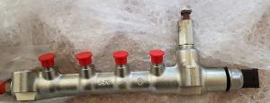

I'm getting a P0181 Error pretty much every morning (starting the car from cold), got the car from a trader and he's been quite good (paying for visits to the garage to get it sorted etc.) so last time the garage he was using replaced the fuel rail with the sensor... The error code still occurs. I don't know whether it's me but isn't the sensor on the end of the fuel rail a pressure sensor?
Yep just replace the sensor no need to change the whole rail
Well the car came with a warranty and they've replaced the whole thing... silly I know. The problem is - the P0181 error code refers to:"Fuel Temperature Sensor 'A' Circuit Range/Performance". and replacing the sensor would help but this sensor is the fuel pressure sensor, and the replacement didn't do anything - same error... So if I'm not correct and the temperature is being derived of the pressure value, what else would be at fault? and on the other side - if I'm correct there's a separate fuel temperature sensor or the fault code refers to a different problem masked by the P0181. Any ideas?

The fuel temp sensor is integrated in the fuel filter housing, not the fuel rail. The sensor on the fuel rail is the fuel pressure sensor.
(7:th-Feb-2018, 08:52:32)stigeye Wrote: The fuel temp sensor is integrated in the fuel filter housing, not the fuel rail. The sensor on the fuel rail is the fuel pressure sensor.
Yes, I'm aware of that. I already changed the fuel filter housing to no avail. Error still pops up.
