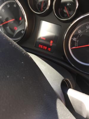

what options will be available ? i have this screen
 [Image: search?q=opel+astra+dashboard&biw=1707&b...LFpEdWM%3A]

I think this could be the picture...
[Image: 1a63eddb5c3f773267e827ef0e14370a.png]

(2:nd-Oct-2016, 12:11:39)Rusty2009 Wrote: I've just walked in from doing one of them
Yes this is the pictures i tried to show you guys haha ..
Its my first post here sorry ..  Newbie
Anyway ! Yes this is the screen I'm so happy to see that its possible cause at the dealer he told me it isn't ..

No not really mate, plug on op-com select year, select body, select IPC (instrument cluster) then program, then program again (only 1 option) then select the extras (most of them won't show on the dash).
