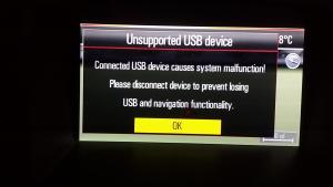

what so the navi is ok but that comes up when you load a usb stick up
I've ad this a few time.
A few steps to try.
1. pull the negative off the battery for 30mins.
if that fails
2. unplug all plugs from radio sd port and usb and replug them in.
if that fails
it's a new SD port.
Thanks for the quick replies and sorry for posting twice. I've pulled the neg for 30mins and unplugged the usb/sd leads all has failed. Looks like its a new usb unit then.
Thanks for the help
ps I did the v208 update and that didn't help, is there an easy way to get the red background on the v208 update?
Not a new USB unit a new sd unit.
The sd puts power to the USB.
I am guessing the Navi card is not being read tho.
yes my SD card isnt being read so my sat nav isnt working.
Also my usb/SD units are both in the same module as in pic so I would have to buy the whole thing.
Now Im on v208 is it possible to go back to v200 or get red background on v208. The blue/white just doesnt look good with the red dashlights

Many thanks Rusty2009, I have just received my new sd/usb and reinstalled the v208 update with new image files. Everything is looking great again.
Thanks again
Your welcome glad you got it all sorted
