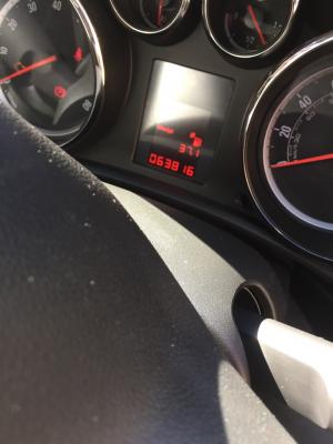

i was just wondering if its possible to activate the trip computer on a 2012 Astra j ?
what options will be available ? i have this screen
Thanks !

Yes this is the pictures i tried to show you guys haha ..
Its my first post here sorry ..
Anyway ! Yes this is the screen I'm so happy to see that its possible cause at the dealer he told me it isn't ..
Well i think I will try to do it on my own It's not that difficult is it ?

No not really mate, plug on op-com select year, select body, select IPC (instrument cluster) then program, then program again (only 1 option) then select the extras (most of them won't show on the dash).
Ah right thanks mate , just having trouble getting opcom working I had the 2008 version so trying to get the newer version goin
