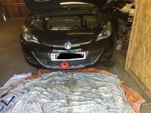

Well today I did a few jobs on the car.

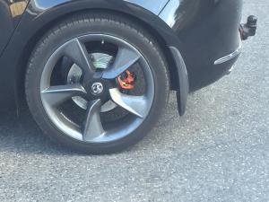

I started by removing the SRI front shocks and springs to change the shocks back to my elite ones.

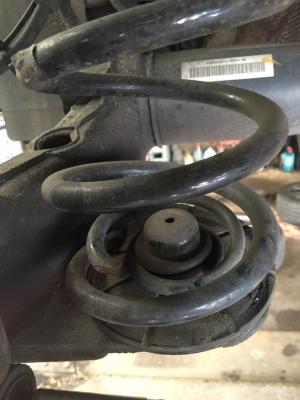

I then moved onto removing the rear shocks and found one of the rear springs had snapped.
So I fitted all my elite springs and shocks back on, I won't be buying another SRI spring as it seems a common issue for the rears to snap.

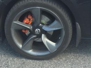

I then proceeded to change all the discs and pads for my EBC ones.
And do a gearbox oil change.
I will get some more pics tomorrow.

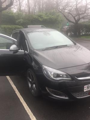

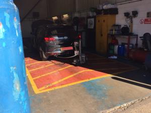

Car is in for her 2nd MOT this morning at 9am couldn't see anything to fail it while under it.
Well it's good news the car passed its MOT with no advisories.
Nice one mate, that's both cars. Bet you're happy!
congrats great news
Yes very happy.

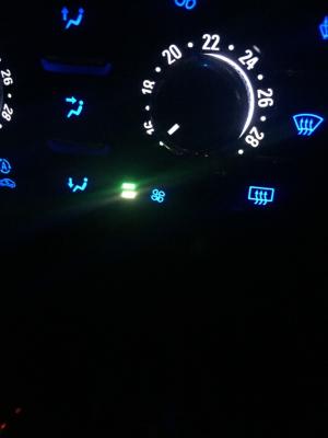

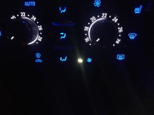

Today I did my Heater panel LED conversion, I've stuck with the same theme white around the dials.
[Image: LED2.jpg]
[Image: LED3.jpg]
That looks awesome! Good job rusty
looks much better
looks really good mate, who would all white look? as Im thinking on that tbh?

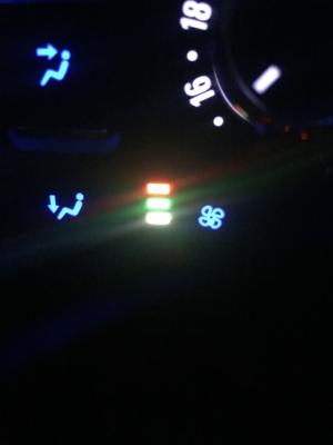

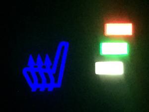

Did some extra changes today in the tell-tell lights as my daughter thought it would look nice and TBH it does look nice in the flesh.
So they go white, green & red.
I've since made the aircon tell-tell green, and will get some better pics later.
i like that well done

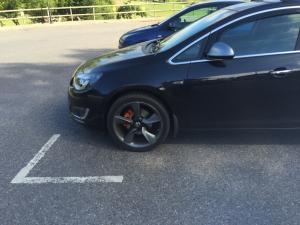

Well she's gone black

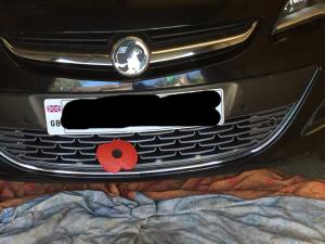

I also swapped grills over for my dark grey one.
Will get some better pics later.

Looks good, although that's one dark car you now have. How did you colour the plastics?
(24:th-Aug-2016, 16:49:20)bhalay207 Wrote: Looks good, although that's one dark car you now have. How did you colour the plastics?
TBF it's not gloomy atall which I was worried about it somehow feels more how it should of been & it ties the doors and dash in.

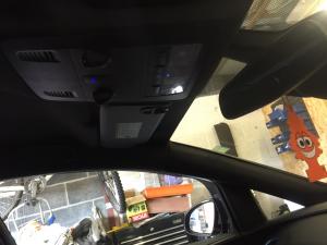

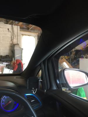

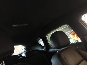

I used etch primer (for plastic) 3 thin coats, and just Matt Black spray paint (3 light coats 1 heavy coat).
Ahh that's ok then. What about the headliner?
well done mate i will get around to doing my one soon
what did you use for the headliner mate
I would love that in our car, looks great!
This is what I used cheapest place I've found it from with free next day delivery too.
http://www.fabricspray.co.uk/shop/uphols...er-6-cans/
Also the headliner will look black after a couple of coats and it is black to the eye but if you take a picture it will look patchy and grey so give it a good coating.

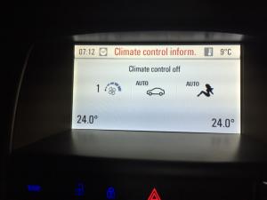

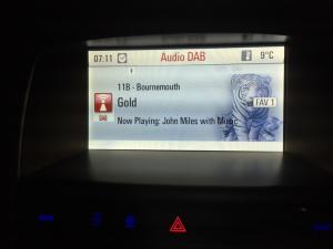

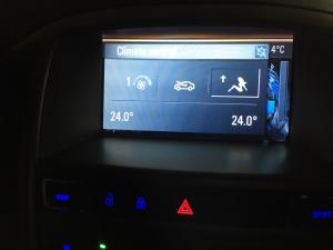

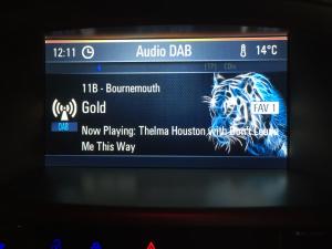

Ok so thanks to another member posting a picture I found a night theme I really liked.
So I flashed it to my navi900
I couldn't find one I liked for day theme so I've started making my own (still a WIP)
Looks good that
Yes, I saw that one too, it does look nice.
Just me that thinks it's bloody awful & tacky? No offence Rusty!
Just reminds me of those wolf jumpers grannys wear.

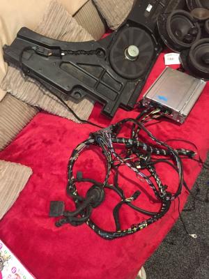

Well I had a parcel today
Very impressed with how much loom they supplied when I only asked for the plugs
Nice rusty !
Infinity setup... Also one of the things I want to upgrade to... Niiiice!!
Glad you got all the looms also

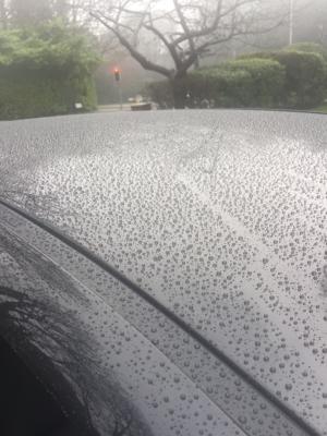

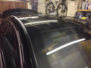

I washed and polished and then put waterblock on Sunday, I just did the bonnet and roof as a test.
The cars been out in all weathers and has been wet, @wellsy said I did a good job and water beed is perfect.
A short drive once the rain stopped and it's dry.
It's also still looking clean which is great as I put off washing it for quite some time.
