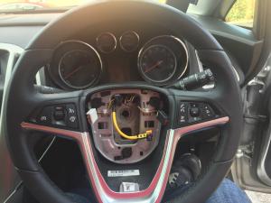

Finally changed the steering wheel. I just need to change the cruise control button now.
[Image: e1bcfb4b436e3a8603f922d37caa372e.jpg]
#66
That is going to feel much better

(28:th-May-2016, 13:18:33)tucpal Wrote: That is going to feel much better
It feels miles better. Hated the old one so much my palms started to hurt on long drives.
