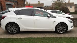

Quite a few people have used 40mm lowering springs, the car below is a 2.0cdti SRI on 40mm SPAX, they also used 20mm HR Trak+ Spacers to widen the stance...
Eibach Pro seem to be the popular go to spring now like on the car below...

Here is my 2.0cdti Sri. I dropped her another 30mm using Eibachs and I've not had any scraping at all, I do still have 17s on though!
