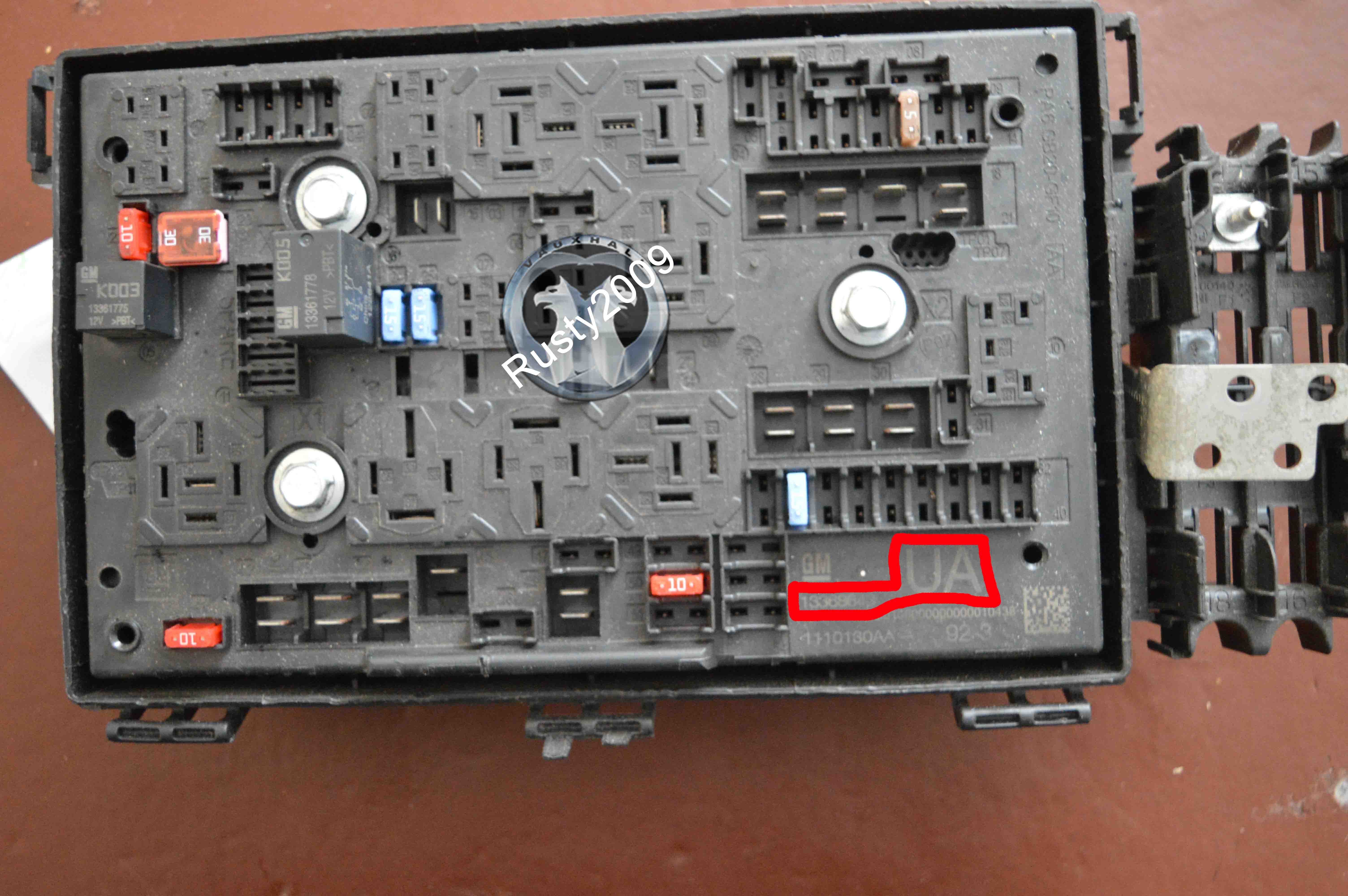

If you have all the fuses relays I see no reason why not, have you pulled the board out and checked you have a full set of PIN's?
I fitted the HBA mirror and I've turned it on via the IPC but tested it last night and couldn't get it working, It's not needed and it's not listed as part of the AFL system.
I could check your part number of the fuse board.
If you can get me the part number and Ident code I've put a red mark around in the below pic.
[Image: 5.JPG]
It must be said that AFL is not a recognized retro-fit and therefore to request the VCI code's I had to select another retrofit option and GM could still refuse to supply the VCI code's.
