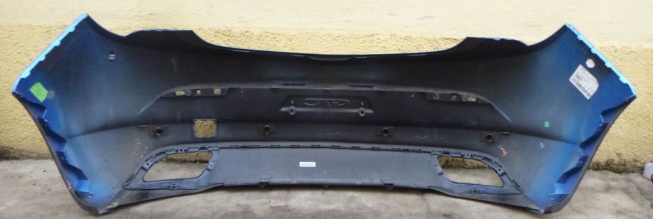

Vxr bumpers don't support parking sensors.
Here is some pics of a guy on the fb page send me. He glued both that sit in the grill.
I'm planning to add a opc bumper too and I think I will ask a friend to do a 3d printed housing to fit in the grill and glue it.. hope this helps

I have not decided the exact location yet, because I need to see what space is available behind the vxr bumper.
Plan A - (red dots) is the two inner will be in the black plastic section either side of the number plate and the outer pair located in the white section at the end of the black section, however I am not sure if the sensors will function 100% in that outer position
Plan B - (green dots) would be the inners and the outers below the headlights, so above the black section
Plan C - depends if plan A and B fail lol
where did he mount the outer sensors ?
#78
Personally I'd go plan B.
#79
My genuine sensors arrived today, two white and two black, so quite limited to where they end up lol
Plan C - I might use the green outer and the red inner positions
Plan D - something else lol
